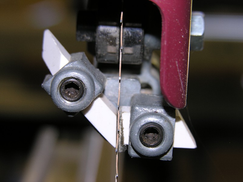

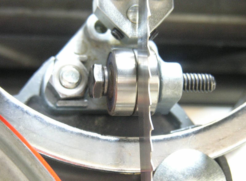

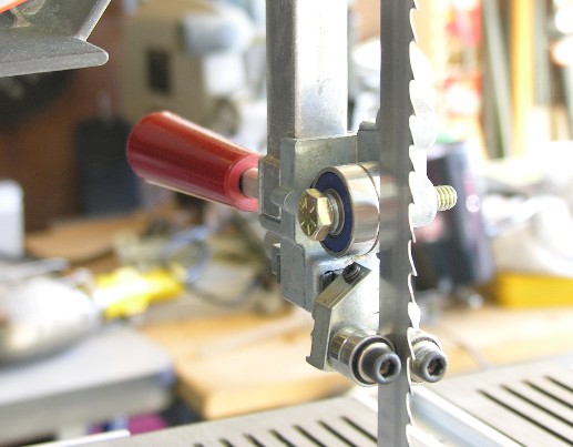

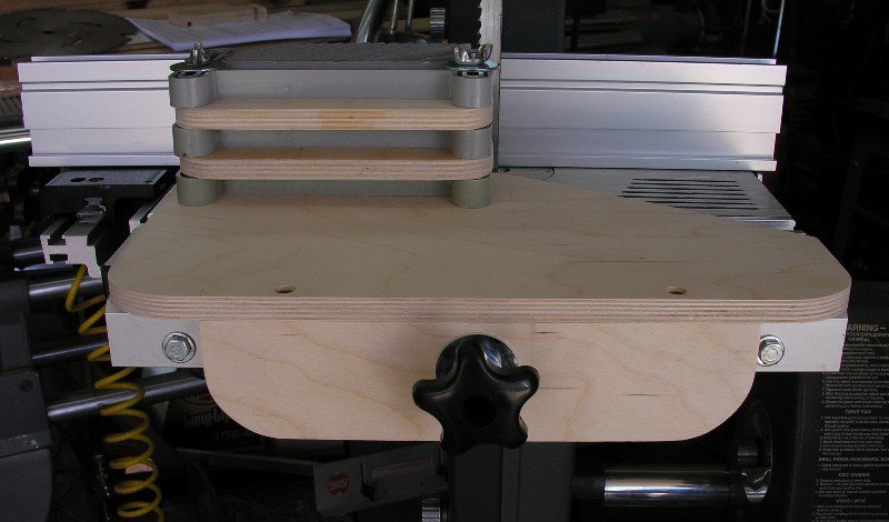

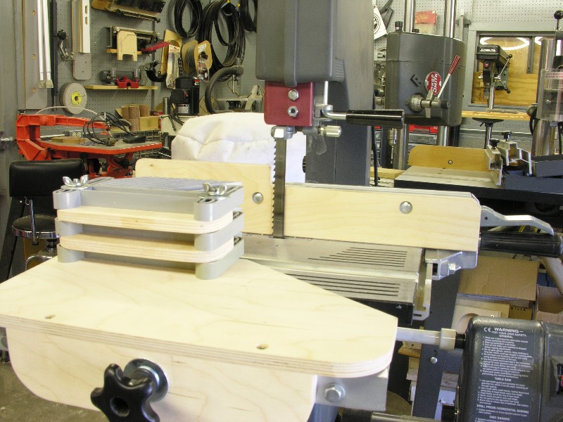

My 2 cents worth on blade drift today. I have always found it strange that we use a 3/4 to 1" thickness board to determine drift, set the fence to the drift and then start resawing boards of six inch thickness. I have found that if I capture (keep) the blade in a double bearing groove in the upper and lower backup and use ceramic or ball bearing guides and a good blade I don't have the blade drift problem. The SS bandsaw is ideal for this setup with its unique tracking system. I have re-posted (hope I don't boor anyone) some of the pics on the bandsaw setup. I have never fooled much with the Incra positioner so I bought the positioner and fence from Rockler last week based on what I have read in this thread. Looks like an interesting tool and Rockler had 15% off.
