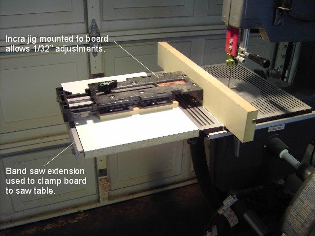

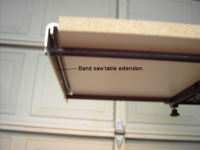

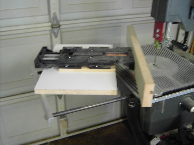

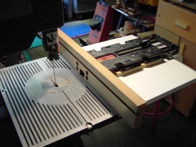

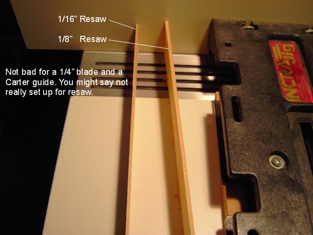

The recent post on the old cast iron band saw table and extension table for mounting the Incra Jig as a re-saw fence started me thinking. I have the newer band saw aluminum table with the table extension option and since I upgraded to the Jointech system my old Incra Jig was just laying around. So, here is my version of the Incra Jig re-saw fence. The Pictures are pretty much self explanatory but, if there are any questions don't hesitate to ask.

Looks like a slick idea. Do you know if the Incra fence adjuster that you used is still available?

Yep! Here's where I got mine a couple of years back...

Nice job on re-cycling the old Incra! Good results too!!!:D

Nice job on the re-saw fence. Do you have issues with blade drift using that fence?
