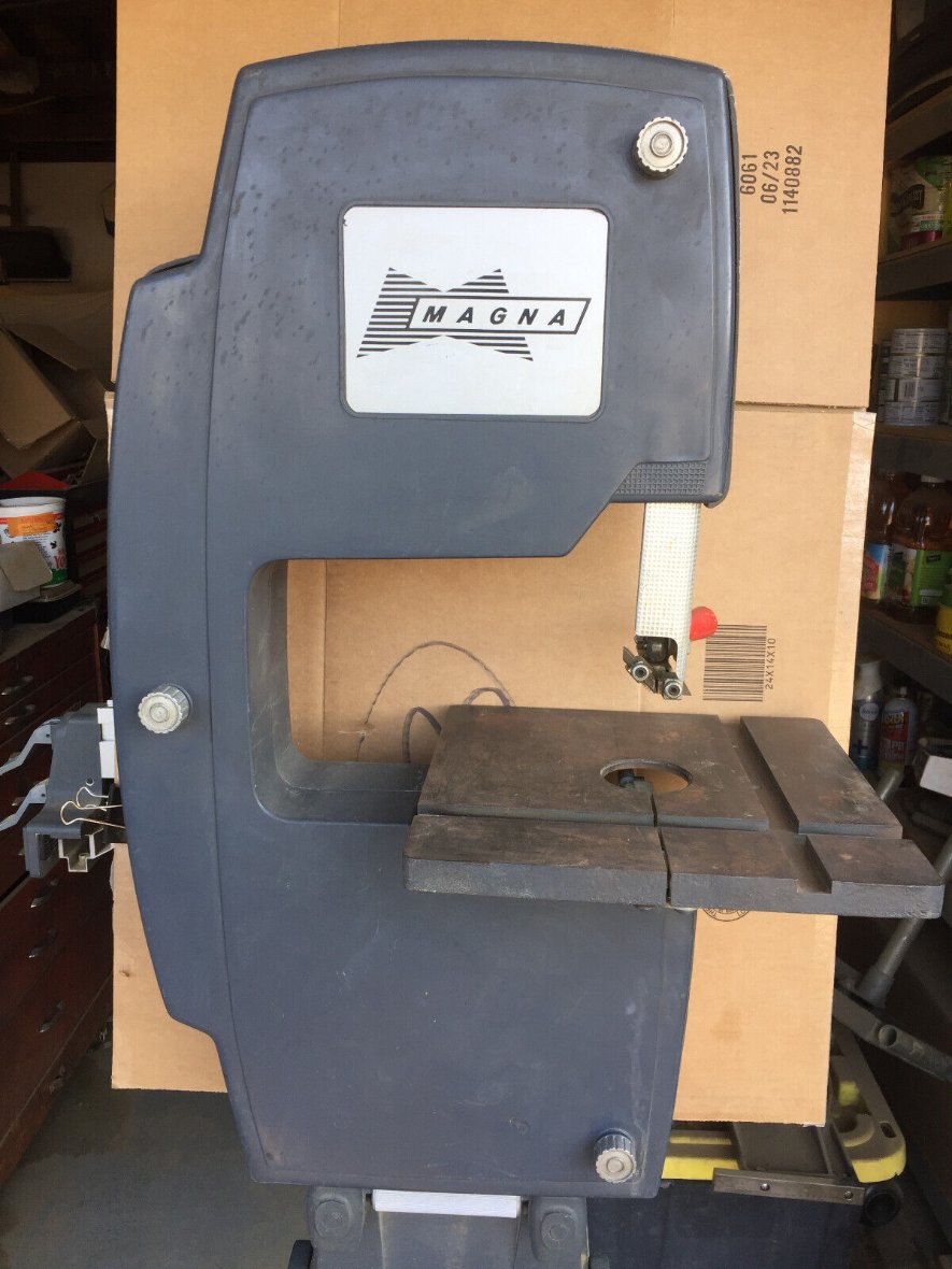

How original of a Bandsaw Cover are you referring to? The Bandsaw was introduced in 1955. The current cover has the dust port which also came on the previous version both of which are later gray covers. The current cover which has been around for about 20 years now also has the slot and window for adjusting the tension of the Blade without having to remove the cover. The original Bandsaw Cover was green and had neither of the above features. That was followed by the gold cover than the gray cover both not having the above features either. Other than that, the logo and how it was part of or on the cover changed several times. The cover itself has not changed in size. You can put a Greenie cover on a current Bandsaw or a current cover on a 1950's Greenie Bandsaw.
Below is the first Gray Bandsaw made in the mid 1960's by Magna American Corporation.
_
It has, what I will call, the plain cover.
For those of you who noticed it is missing the Table Insert but I do have it and once restored it will be in place. :)

Another thing that has changed is the method of attachment of the cover to the saw frame.

I've had SS bandsaw covers with three different types of attaching hardware. My favorite is the old knobs shown in the photo above posted by Russ. My least favorite is the latest version which require a tool. That has to be a safety thing, but it isn't intuitive to me how it could be any safer. I haven't noticed any difference in the cover itself for the various attach methods. The 'standoffs' are different for the version that requires a tool. (New standoffs have female threads.)

Re: Bandsaw upgrade
For a 1980's Bandsaw the cover would be the same as the cover in the picture I posted in my previous post except the would say Shopsmith instead of Magna. The Dust Port was added in the mid 1990's. Shopsmith makes an upgrade for covers that do not have the Dust Port. It can be found at the following link and includes the flange, an elbow and the hardware to attach it. Another option would be to upgrade to the current cover with the Dust port and the window plus slot for adjusting the blade tension. It comes up for sale from time to time.
