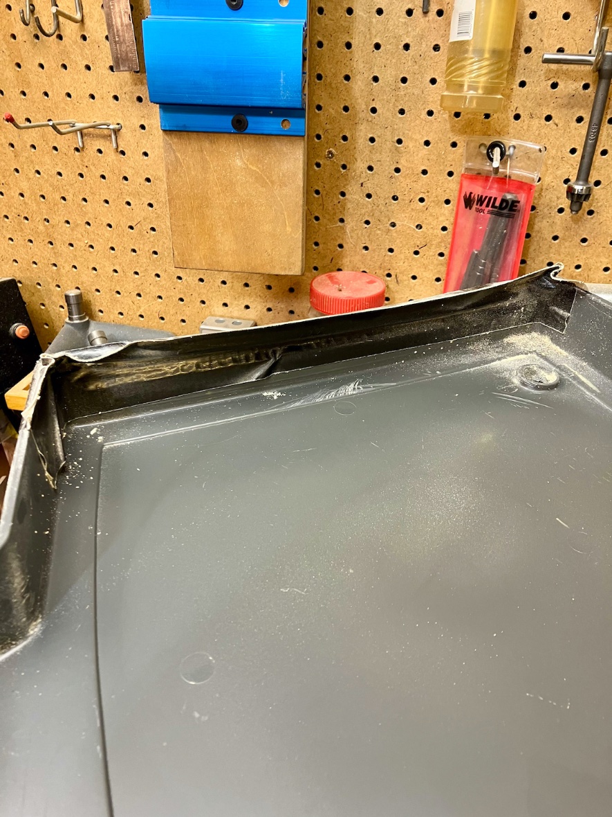

Matanuska wrote: Thu May 02, 2024 12:52 am Is that a 4” flange? Must do a much better job of catching the sawdust that otherwise falls through the slot on the bottom of the bandsaw.
My solution for dust falling out the bottom of the bandsaw is duck tape stuck one piece on the inside and one on the outside sticking to itself it works surprisingly well.

gleno wrote: Fri May 03, 2024 8:21 am My solution for dust falling out the bottom of the bandsaw is duck tape stuck one piece on the inside and one on the outside sticking to itself it works surprisingly well.
It doesn't look like you have a dust port attached. Does the bandsaw fill up with sawdust with the bottom sealed up?

Post by gleno »
Yes I do have the Shopsmith dust port, I've never had enough dust inside to be a problem I just vacuum out the saw when I change blades.
