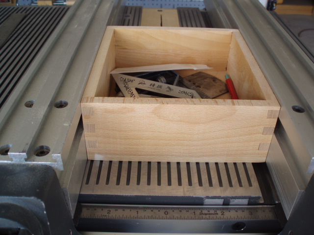

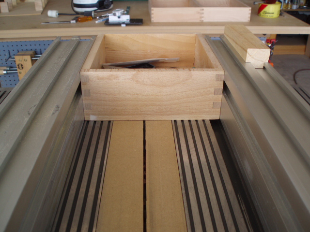

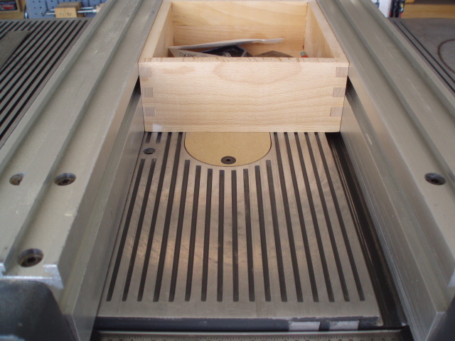

My 520 fence deviates .005" from front to back. The Crafters Station Fence (mounted on the Mark V) is actually better (.004"). The CS Fence was purchased off eBay from one of the Folkerths.
[ATTACH]5233[/ATTACH]
[ATTACH]5234[/ATTACH]
[ATTACH]5235[/ATTACH]
My "loose parts box" is 7 1/16" wide. It slides the length of two rip fences (squeezed between those fences) with equal resistance the entire length. One fence was aligned on the CS and the other on the Mark V. I think this demonstrates that two fences, perpendicular to the same rail are parallel (in fact) to one another. Parallel means "at all points equal distant".
