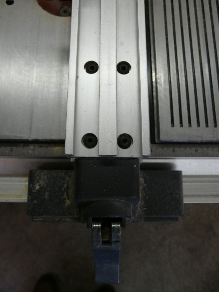

The four screws shown in the first photo are the ones to use for alignment of the fence.
[ATTACH]5206[/ATTACH]

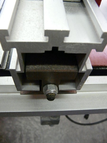

The lock nut shown in the following picture adjusts the pressure of the rear lock down on the fence. It should hold without slipping but does not need to be so tight that it makes locking the leaver down difficult.
[ATTACH]5207[/ATTACH]
