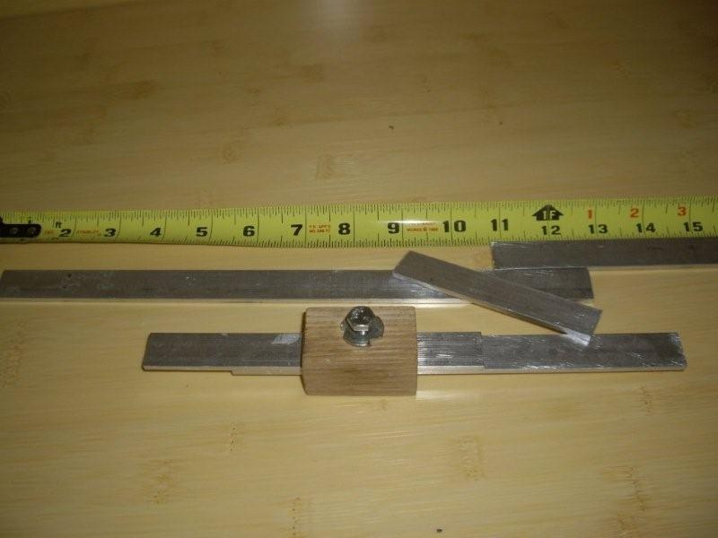

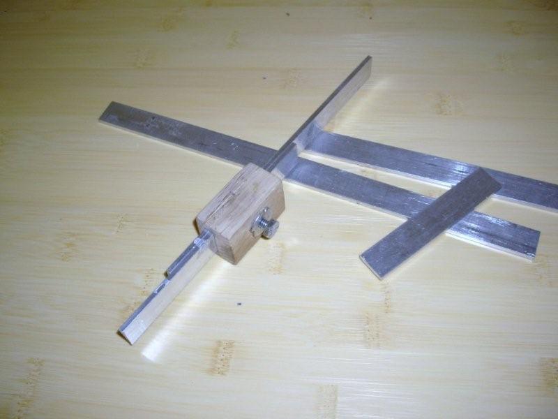

Great idea! Will make one for larger cases. I made one that uses 1/2X1/8 aluminum bar stock for measuring for drawer bottoms, inset drawer openings and etc. The thin stock allows measurement inside the drawer bottom grooves.
Mine is just a piece of wood that I cut a groove in to house two pieces of the bar stock. Then glued another piece on the bottom to capture the stock. Added a "T" nut and set screw. From a 4' long piece of stock, I got enough different lengths to measure almost any size drawer.

Gene, great idea... but I am having trouble picturing it. Could you please post a picture or 2. Thanks in advance...

Gene - The use of aluminum bar stock was a great idea. Yep! There are many ways to make one of these sticks. I just might try something along this line.Gene Howe wrote:Great idea! Will make one for larger cases. I made one that uses 1/2X1/8 aluminum bar stock for measuring for drawer bottoms, inset drawer openings and etc. The thin stock allows measurement inside the drawer bottom grooves.
Mine is just a piece of wood that I cut a groove in to house two pieces of the bar stock. Then glued another piece on the bottom to capture the stock. Added a "T" nut and set screw..
Here's a couple pics of the aluminum bar story stick.georgek1 wrote:Gene, great idea... but I am having trouble picturing it. Could you please post a picture or 2. Thanks in advance...

When you make more of these, make the t-nut captive. Counter bore(for clearance) on the side facing the sliding bars b4 glueing. This will eliminate the tendency for tightening to back the t-nut out.Gene Howe wrote:Here's a couple pics of the aluminum bar story stick.
[ATTACH]5755[/ATTACH]
[ATTACH]5754[/ATTACH]
I thought about doing that but, it was just going to be for a few drawers. That was 8 years ago. The nut (EDIT-BOLT) is just finger tight. I hasn't come apart yet and, I use it at least once a month.JPG40504 wrote:When you make more of these, make the t-nut captive. Counter bore(for clearance) on the side facing the sliding bars b4 glueing. This will eliminate the tendency for tightening to back the t-nut out.
