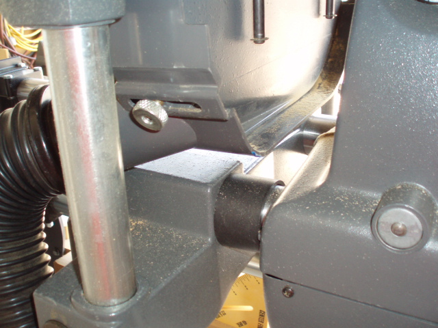

I think the lower saw guard is adjustable so you can change blades or move to disk sanding both without having to remove the guard.
...loosen the hex nut holding the lower guard to quill to allow the blade/sanding disk the room to slide on or off the arbor.
I position mine so it is very close to tie bar yet still misses it when I lower the table. Having an upper vaccum port via the Saw Shark (oem upper blade guard) pretty much collects all my dust.

For what I have been doing with the dust collector, the tie bar and tie bar guard are almost in the same vertical plane and therefore establish the same lateral position of the lower saw guard.
As for width of opening - placing the lower saw guard up against the tie bar or tie bar guard (as a point of reference) is about as far open as you can go. If you open any further, the lower saw guard impedes the table when you attempt to lower it.

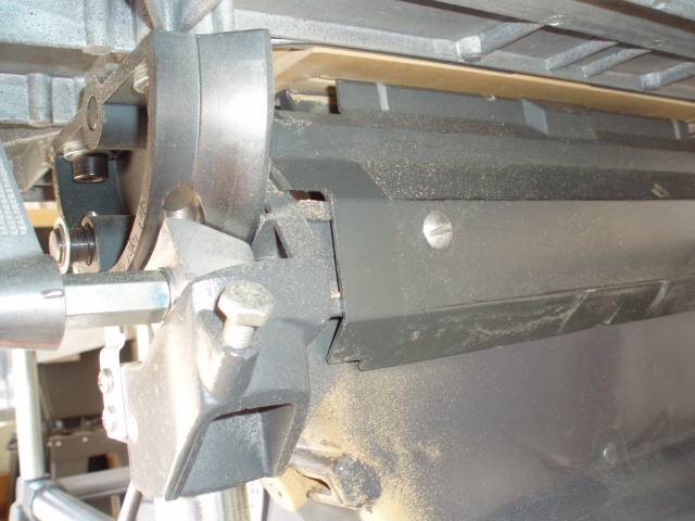

I had to rush down and see if mebbe I had removed the TB Guard for some reason and forgot to put it back on, but alas, when I looked-- the Guard is riveted to the tie bar, so there's no question it will always be there, but I'd forgotten about it because it does appear to be part of the tie bar, not a separate item.
(I may have to spend a few seconds wondering why the parts listing shows screws fastening the Guard to the tie bar, when I have rivets. )
And I see I need to make a correction. I'd earlier reported I used painter's tape to seal the gap between the tie bar and the table underside, well, it's the Guard what gets the tape, of course. And sealing that gap does help, a lot.
On my 510 the Tie bar guard is attached with screws. Didn't know there was another way. I remove the plastic guard in order to use dust collection from below while using the insert with the round hole (router/molder insert). Often, I forget to put the guard back on.
The only times I adjust the width of the lower saw guard is when changing from a saw blade to a dado blade.

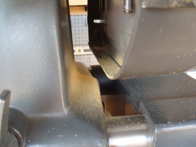

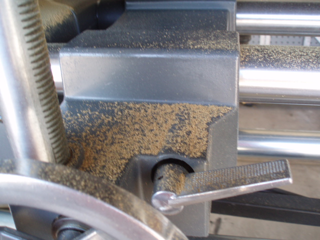

This is the saw dust that I am trying to get rid of via the dust collector rather than broom and dust pan. What you see here is the result of one pass through a piece of 1" MDF about 4' long.
This is not a lot of saw dust but if you cut up a couple sheets for a project you got a lot of sweeping to do.
"Making Sawdust Safely" Dusty
I have been trying to figure out exactly what Dusty showed in his photographs. I attached a cardboard cutout to the inner guard assembly that filled in the front of the lower sawguard, raising the effective height to the table regardless of where the height of the table was set. This did not really stop the small cuttings from landing on the carriage. It seemed that most of the cuttings were coming out past the top of the tie bar guard, which does not come all the way up to the table to allow for table tilt. Keacaps solution to put tape from the top of the guard to the table seems to have met with good success.
