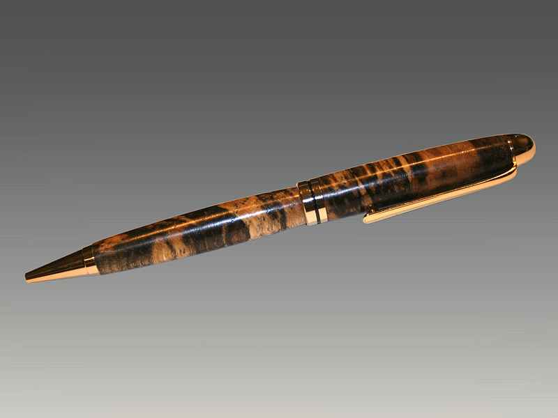

Anyone had any experience in turning cross-grain cut pen blanks? I have a real nice Spalted Hackberry cross-grain blank I just drilled and glued. I plan on turning it tomorrow, and haven't turned any cross-grain before. Anything I need to be cautious/aware of, other than sharp tools and slow cutting?

tom_k/mo wrote:Anyone had any experience in turning cross-grain cut pen blanks? I have a real nice Spalted Hackberry cross-grain blank I just drilled and glued. I plan on turning it tomorrow, and haven't turned any cross-grain before. Anything I need to be cautious/aware of, other than sharp tools and slow cutting?
Tom,
Your thoughts are right on target. I would want my tools perfectly sharp. I would be certain to have plenty of light. I would prefer to work with this blank when I was fresh and not the least bit fatigued. Most importantly I would remove sharp corners prior tro mounting the blank on the lathe. This step can be accomplished by either a band saw or very carefully with a belt sander. Good luck I look forward to pictures of the finished project. fjimp

Well Jim, it wasn't as bad turning as I thought. Finishing was another matter though :mad: Wood seemed real "sappy" and the shavings even "caked" on the chisels some as I turned. Sanding it clogged the grit of brand new sandpaper, and I could even detect a slight smell like turpentine as I sanded. Finished out OK though. The blank was one of the "premium" blanks from PSI. Here's the finished product.
[ATTACH]6125[/ATTACH]
