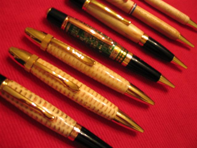

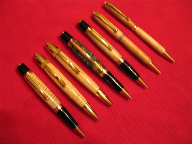

since the guys made me get the camera out to snap pics of the extension tables i took some pics of the afternoon's work. these were all partially done before this afternoon as i have done two demo's recently at my woodworking clubs. with five craft shows coming up i need to build up inventory anyhow. from left to right they are three corn cobs, a printed circuit bord, box elder and two cherry one with red, white and blue poker chips in the center. they guys love to see the corn cobs done starting with a cob fresh from the field they are not stabilized, just turned and hardened with ca glue as i go, then polished with micro-mesh to 12000 grit and then brasso.

i'm not a super turner. lol these pens were all at least partially done from demos that i've done at two different woodworking clubs lately. the corn cob pens only needed a couple more coats of ca, polished and assembled. the circuit board pen only needed a little more polishing and assembled. the two cherry pens did need minimal turning, finish and assembled. here is a link to the club newsletter if interested. also keep in mind that bettyt is really bob on this forum. bob

Can you expound a little on the PCB pen? Exactly what did you use for the blank, something you made yourself or purchased? How did it turn?
Nice looking pens. A couple of questions for you. What size bushings are you using for the corn cob pens. I only have the 7mm slimline setup at present. Curious whether the larger bushings will fit on the standard mandrel I have currently. Thanks for sharing your club newsletter. BTW - Is that you doing the demos?

printed circuit board pen
the printed circuit board pen blank was made by a fellow pen turner
"bruce119" at penturners dot org. there is a process that he uses to disolve the orange part of the circuit boards so they can be wrapped around the tubes, then cast clear resin over them. we had a group buy and were able to get them for $14 each. i just bought three, in hindsight i should have got more because i did not how popular they would be. woodcraft and bera hardwoods now sell a kit that looks like them for $20. the big difference is they are not circut boards but are pictures printed on a lable. they do look nice gotta look close to tell.

rkh2, yes that is me old bald me in the photos. each pen kit uses it own bushings. so every time you try a different kit you will need another set of bushings and probably a new drill bit too. the good news is most bushings will fit the mandrel you have. there are a few larger diameter pens that use the larger "B" mandrel. the first corn cob pen is a "Wallstreet III" and the other two are "Polaris" kits all from woodcraft. i use them because the are pretty large in diameter. "Cigar" pen kits work great with corn cobs also. you can search for corn cobs with the center pith area small enough for a slimline. if you know anyone that raises popcorn the cobs are very small and work on slimline pens. some places sell popcorn still in "ear" form. get them if you can. i have two nephews that are dairy farmers and raise corn for feed. pretty soon i'll walk the fields picking up the smallest cobs i can find.
