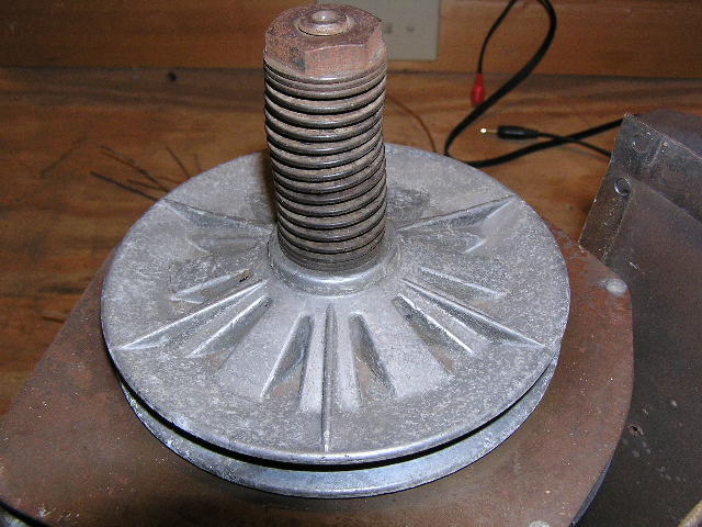

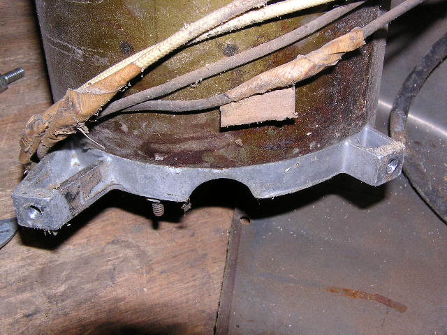

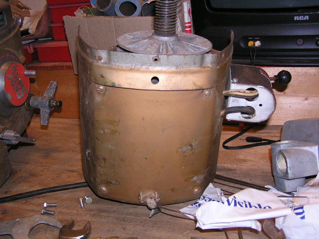

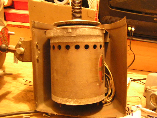

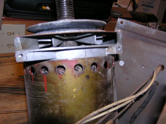

I think the access hole was 'added'. The holes for the locating 'pins' look different on later models. The top and bottom holes have been drilled as well as the outer circumference of the 'hole'. The hole appears to be the size of the 'smaller' access holes.
The motor capacitor is most likely in the dayton switch. To reverse 'switch', the control needs access to the leads connecting to the capacitor.
I 'BET' the motor has a ss type mount 'cobbled' from the original motor and screwed into the motor outer shell/frame. The motor MAY even have the original ss fan blade and 'end cap'. Like farmer, I would love to 'see' it.
P.S. as an after thought, It may even BE the original motor with the capacitor leads brought out to the dayton switch.

Motor Pictures
Guys - got up early before my flight out this morning and pulled the motor out of the pan. If it was added later, they did a nice job as the SS mountings look - to my untrained eye - untouched and original. However, the power cord and forward / reverse switch appear later addons - the cord is held in by a screw-on retaining ring versus the molded plastic plug and there are some holes drilled behind the switch that appear to have been mistakes (you can see the holes in the first picture).
Open to everyone's thoughts and ideas!
