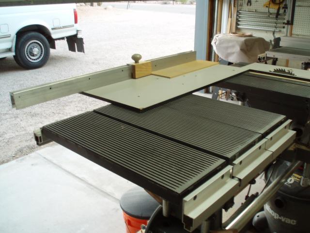

Thanks for the photos. I use the SS cross-cut sled, but have been wanting more functionality. I like your design. Could you elaborate a bit on your add-ons? I suspect I know what you are doing, but could benefit from hearing you describe it. Your fence looks like a SS fence attached.

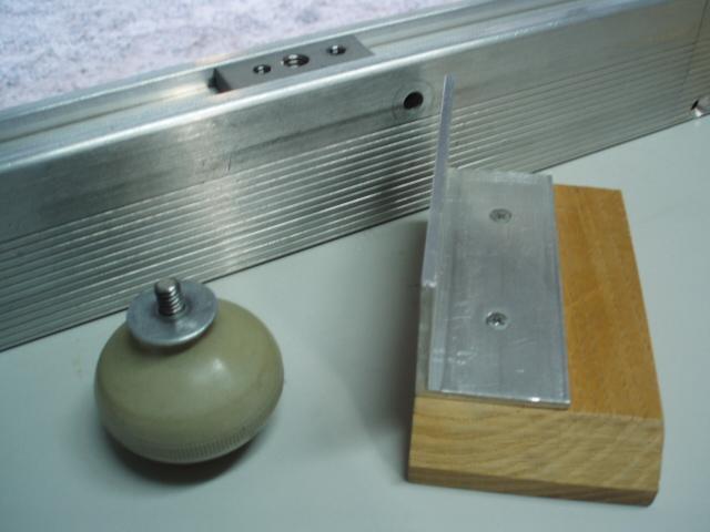

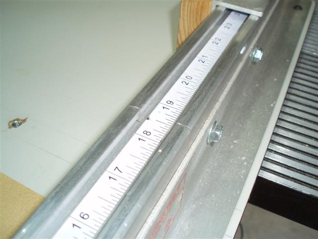

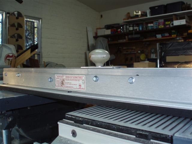

The addons are, as you detected, Shopsmith parts. I used the extruded aluminum from 510 rip fence and a band saw fence. They are simply drilled for bolts and mounted to the Shopsmith Sliding Cross Cut Table (555535).
I also modified the Auxiliary Crosscut Sliding Table. I moved it to the right so as to eliminate the gap between it and the sliding cross cut table. This requires moving the plastic miter bar. I then cut a kerf in the Auxiliary Table making a ZCI. The kerf functions as the cut line as it very accurately identifies the right side of the blade.
I've thought about enlarging the size of the auxiliary table but have not gotten around to it. I would extend it to the left about 12" and to the outfeed side by at least that far.
The added feature is the T-Track on the rail. I don't know what I did without it. Oh yeah - and some added weight.

Are you putting the two fences back to back to get the length? I did not think of using the bandsaw fence since it seemed smaller than the other fence, but in your photo, the fences seem identical.
Nick had used a wooden fence in one of his Sawdust Session with a slot added to the top for the t-track, but the aluminum fences seem to work well and the t-track slot is ready to go.

I have not bent any aluminum in these projects. I use aluminum angle that can be purchased at the big box stores.
Aluminum is quite easy to work with. I am told it can be cut on the table saw with a carbide blade but I have not done that (yet). I have a blade for the band saw that I dedicated to cutting aluminum and I use that. I smooth the edges with the belt sander, smooth flat file and emery cloth.
Be aware that using these fences you do loose about an inch and a half of cross cut capacity.
If that is an issue, you could very easily resolve that by building from scratch.
PS 10/17/09, Thought these might add some clarity.

Thanks Dusty
Dusty,
Thanks for the additional photos. I've got it.
I like this solution instead of the wooden fence from Nick.
