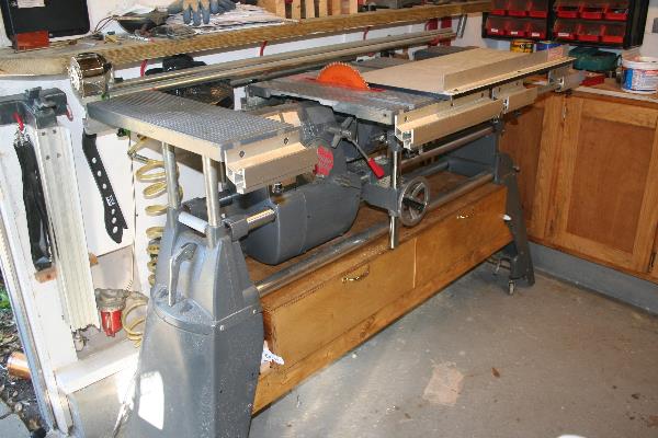

I don't have a set of plans, but i'm attaching a picture of the set of drawers I made to fit under my SS. If you were interested, I'd be more than happy to make a drawing with dimensions etc. Not sure if this is the type of thing you were looking for. They hold all the tools and attachments i use regularly, since i upgraded the wheels the SS still moves quite easily.
I like your idea better than the plans where the unit hangs from the tubes. Your design looks simple compared to the others. If you have more photos to add that would be great
