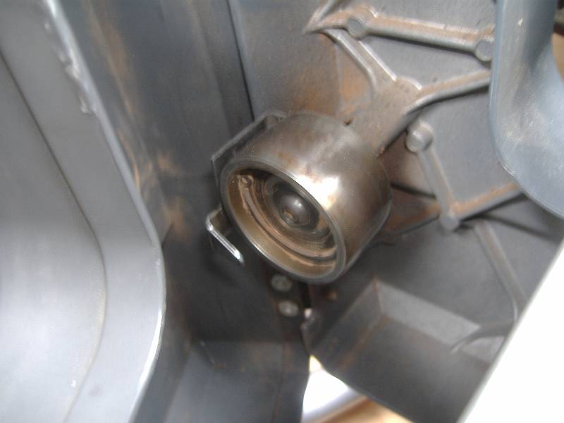

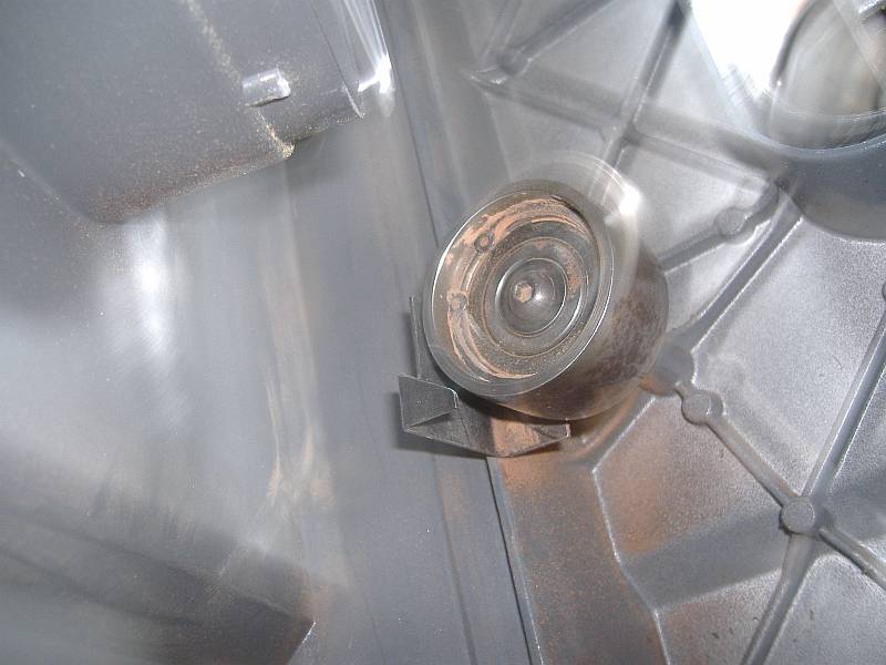

A little cool in the shop today but I took a couple of pictures of the guard. Looks like one could make one if you needed to but if it cheap it might not be worth the effort.
[ATTACH]6897[/ATTACH]
[ATTACH]6898[/ATTACH]

Thanks for the photo. I am sure that is the reason the belt does not track center. My sander is dated 12-1988. I know this sander has changed hand a few times so hard to tell what is original and what is not. Sounded like the guy I got it from received it as a package deal with a model 500.

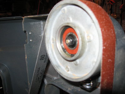

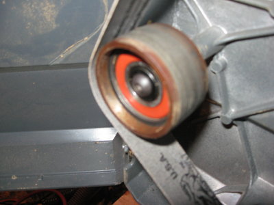

Below are some photos. Here is a pic of the bearing. It has some kind of rubber shield (orange in color)

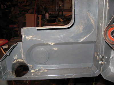

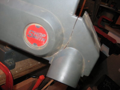

This shows the front cover. The previous owner had something going on wrong. The groves inside the front cover are deep and thread in the belts was melted into the cover.
If you look by the dust port you can see the cover was cut clear through.

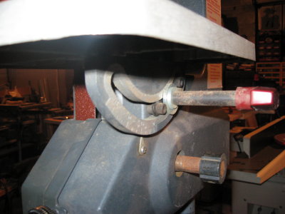

Here is a photo of the trunion. Is it thicker than new models?

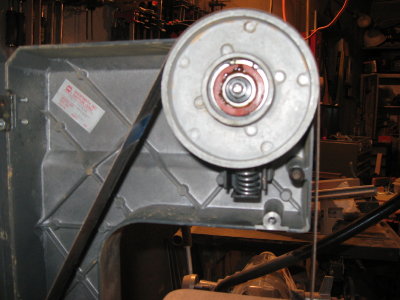

Look at this photo. What is the screw for just to the five o'clock position of the upper wheel.
I am not talking about the hole where you move one of the small wheels to. The one in question has a screw in it.
cincinnati wrote:Look at this photo. What is the screw for just to the five o'clock position of the upper wheel.
EDIT - - This post is in error :o - I looked later and found my tracking wheel spring to be in the same location as Cinncinnati's! But my spring (the origional) is lighter duty.
\Don't know what it is for! I see your machine is different than my newer model. My tracking wheel spring is located behind the wheel/ \with a bent metal bracket to hold it in place. Your spring is below the tracking wheel. /
Looks like there are more differences than plastic idler wheels.:confused:
