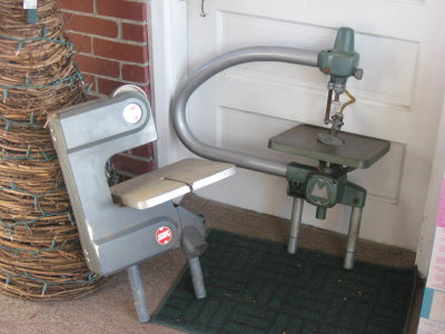

I scored a Strip sander (1988 year model) off Craigslist. $50 for the sander AND older jig saw.:D
The strip sander is missing a few parts. The little wheel just below the upper spring loaded wheel is missing. Also the 3 platens are missing. Kinda surprised the curved one is $25 from SS. Anyone seen a sale lately from Shopsmith? They use to run a parts sale all the time.
Any tips on what to look for in doing my rebuild? The upper spring wheel is kinda stiff but does work.
Looks like the sander was run to the point the belt almost cut the cover in two by the dust port. The cord in the sandpaper was melted into the cover.
Makes you wonder what people does to their tools.
I noticed in the parts view on line it says for sanders prior to 1999. What changed after that date?
Any tips or experience with a rebuild is helpful.

Maybe a picture with the cover open so that WE can see what's missing.:)

I have encountered two versions. The newer ones have ball bearings and aluminum idler pulleys(2). The older ones had bronze sleeve bearings and plastic idler pulleys. I think the newer ones are preferred but I do not know if the older parts are available.
The 'ball bearing' version pn's are 515390(idler), 515422(bearing), 515409(retaining ring), 515405(1/4-20x1 1/2 cap screw) - from manual 8/93.

I tore into my sander tonight. A 4" wood screw fell out of the top wheel housing:confused: The spring was broken but 65 cents later at Sears Hardware and was ready to go.
My idler wheels are metal (heavy at that) and the have German made bearings:D Was going to order new ones but not if I am going to receive plastic with bushings. Any other new strip sander owners, What type wheel are in your unit?
