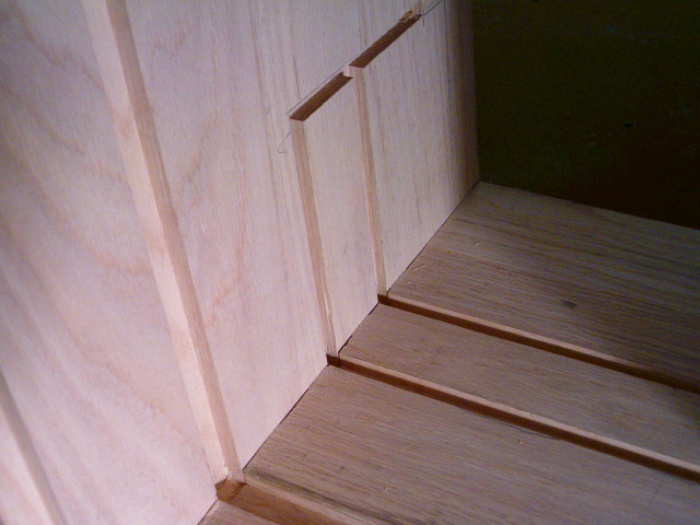

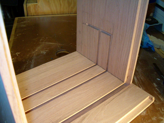

Here are a couple of photos of the grooves, dadoes and rabbet milled on the inside of the box. The till box grooves and dadoes are 3/8" X 3/8" - the rabbets and the chest bottom are 3/4" X 3/8". They will hold the till box, chest bottom and drawer frame. All grooves were cut on the OPR. The OPR made it easy to align the grooves from the ends to the back, without making a right angle jig like the guys in the magazine.
I managed to break out one of the lower tails at the end of the lower rabbet, while re-assembling the chest. I knew this area was going to be brittle as it is now only 3/8" thick, but managed to break it anyway. No problem - I made a plug for the hole that is not really needed, as that area will also be covered by molding.

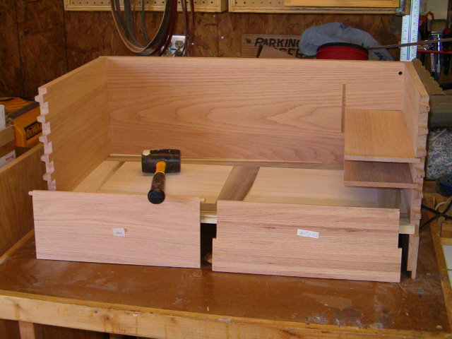

Here's the progress since the end of January - made the two bottoms of the till box, the top of the till box and the side of the till, and just finished the chest bottom.

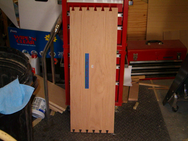

In the first photo, the bottom is sitting in its grooves and the top and the side are leaning against the chest bottom (poplar). The chest is glued together on the back sides. The second photo shows the lonesome chest front.
The till top is on the left and the side on the right. All of the till pieces are 3/8" thick. The top fits into the vertical dadoes and the narrow part fits the width of the chest. The side can slide up to reveal the second bottom. This is supposed to be a small secret shelf to hold valuables. (Not so secret any more)
The top looks like it has two dowels, but these are really ears of the solid top. Since the pivot holes for the top are 3/8" the only way to make hinge pins was to use the top itself. This brings me to two mistakes made earlier. 1) I glued the sides of the chest to the back before drilling a hole for the top hinge. This caused me to drill a hole through the back, which I will have to plug later. The hinge hole in the front is only 3/8" deep from the inside. (the correct way) 2) In making the top I sawed the first piece to the width of the chest. This left nothing for the hinges. I now have a new piece of scrap.
Also the first till box side was fitted so it was a bit short (1/16") of reaching both the front and back. The second piece fits better. This piece was made from 3/4" cutoffs that I just couldn't throw away. I had intended to make both the top and side from these glued up boards, but such is life in my shop.

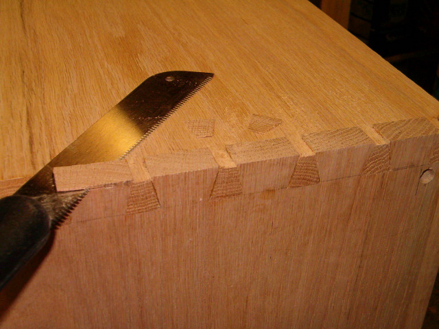

Got started on that then got sidetracked by trimming off the protruding tails and pins. Used a flush cutting pull saw to remove them. The saw worked very well, only a few light scratches in the faces. They can be easily sanded off. The saw is very sharp and the small slice between my thumb and index finger attests to that. Should have been wearing my protective carving glove.
First photo is sawing off a tail. -- The hole is for the till lid hinge and will be plugged.

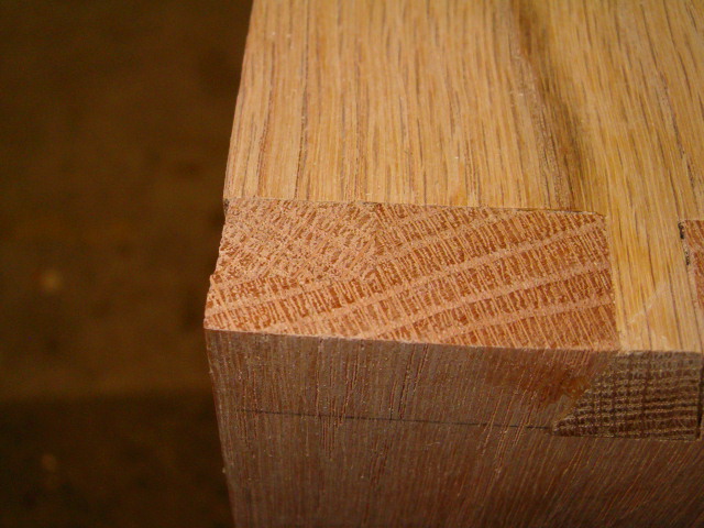

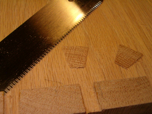

Next is a close-up of two pin excesses removed. They look thin and are! The thickness measures 0.019" This also happens to be the thickness of the saw blade.
[ATTACH]7916[/ATTACH]
Mentioned earlier I broke off the end of a rabbet which would have made a hole in the side of the case. The next photo shows the plug on the ind of that tail. Although the grain slopes opposite, I don't think it will be noticeable. In this pic, you can see a scratch on the face of the pin top. Also note that pin has been sawn level.
[ATTACH]7914[/ATTACH]

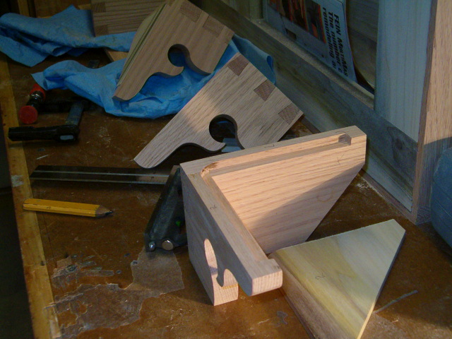

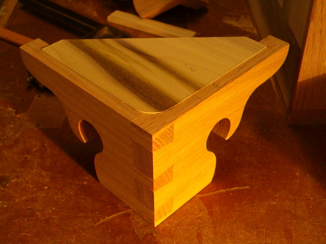

Now close to finishing up the feet - changed to a 7º by 5/8" bit to do the dovetails in the feet. After gluing the dovetails, routed a rabbet on their top to hold a 1/4" triangular poplar plate. The plate will be screwed to the bottom of the chest. There will also be a 3/4" X 3/4" oak block fastened to the inside corner of each foot. The block will be 1/16" proud of the foot bottoms to take the wear off of the decorative oak, and it will present end grain to a floor rather than edge grain.
