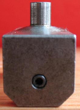

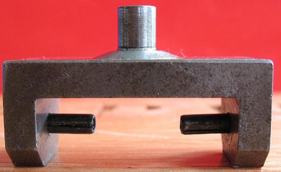

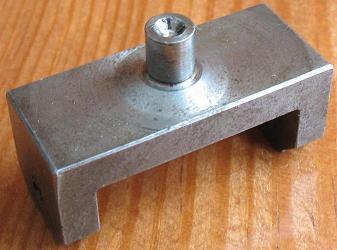

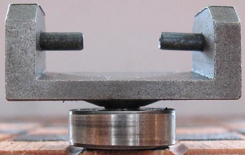

I am researching different types of bearings for the follower; Here are some pictures from my M7.
~Ryan
~Ryan
- IMG_2616c.JPG (22.72 KiB) Viewed 5882 times
- IMG_2584c.JPG (32 KiB) Viewed 5875 times
- IMG_2595c.JPG (17.29 KiB) Viewed 5868 times
- IMG_2390c.JPG (29.91 KiB) Viewed 5874 times

I got all of my bearings from VXB in California online. The quadrant follower bearing was a 6 mm X 11 mm X 6 mm size and cost a couple of dollars. The new follower he made me is steel. I should have it by Tuesday and will let you know how it works out. How did you get the bearing off of yours without breaking the center pin????

[INDENT][INDENT]wannabewoodworker wrote:The quadrant follower bearing was a 6 mm X 11 mm X 6 mm size and cost a couple of dollars.
[ATTACH]8026[/ATTACH]
Well.... it wasn't easy.
I had to wait until it was nap time.
Actually, I used a push-rod (through the sheave) to remove the bearing/follower. Then, very gently, used a bench vise to hold the bearing][/INDENT]

I did the same thing to get it out of the sheave assy. but then when I tried to pull the bearing off with my newly purchased bearing remover it just yanked the damn pin off. I should have analyzed it a bit closer before going to town on it. Lesson learned on that part. Your method of tapping it out was a better way to go and knowing what i know now that is exactly how I should have done it as well................
