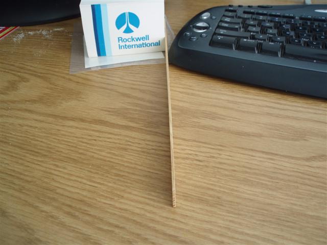

Using a Bandsaw to Rip Cut
is not a difficult task. The operator must pay attention to detail, however.
Actually, I do not know exactly what I did to eliminate my symptoms of a drafting bamd.
I still have the same blade and the same cool blocks installed and the cool blocks have not been adjusted.
I did have the blade off so tension might be different. I know for certail that the cool blocks have been lowered to just above the stock being ripped AND
I am using a different fence.
I have a low profile fence attached to the table right now so that I can rip real thin pieces. Cutting thinn pieces I could not get the cools blocks low enough with the regular fence.
CONCLUSION: As someone has already implied - OPERATOR ERROR.
[ATTACH]8718[/ATTACH]
1/16" thick
[ATTACH]8717[/ATTACH]
1/32" thick

- Posts: 35598
dusty wrote:is not a difficult task. The operator must pay attention to detail, however.
1/16" thick
1/32" thick
Have you tried cutting THIN strips?:D Those thick ones look good!;)
P.S. The 1/32" strip looks thicker than the 1/16" strip.. . . . . . . . . . . . More 'Operator error'??????
