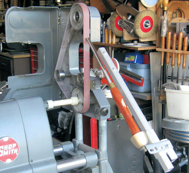

homemade strip sander chisel sharpening attachment
efmaron wrote:Peter,
That is a beautiful piece of sharpening equipment you made. As others have said I do not see a need for you to buy one yours looks great.

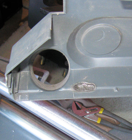

Well, I discovered one reason to run the strip sander in reverse. I was happily sharpening every chisel in sight and found that the hot sparks were melting a blister in my strip sander cover. See the photo below.
[ATTACH]8987[/ATTACH]

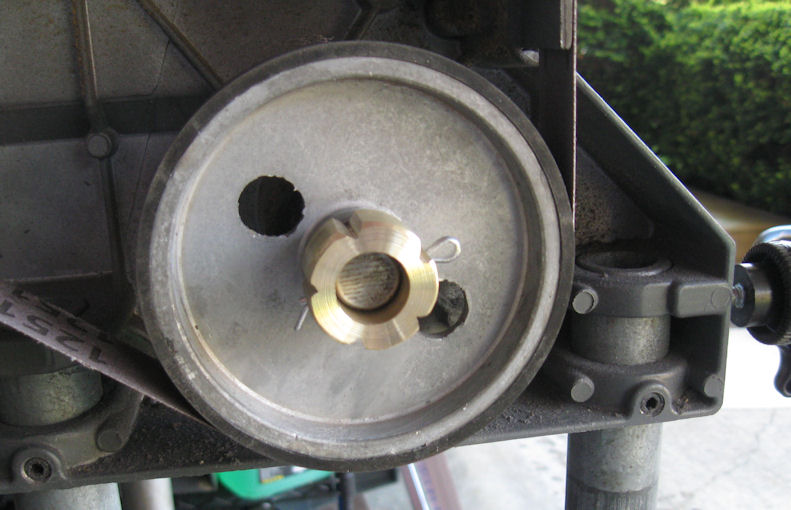

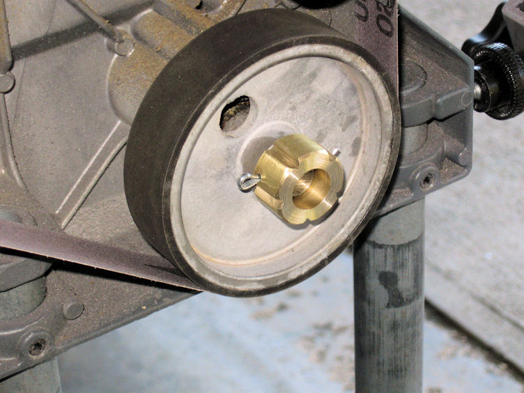

I decided to look at mounting a hub on the belt side, as described by Bill Mayo awhile ago. My shaft sticks out 0.31” so, not much to work with. I succeeded in drilling a 1/8” diameter hole through it using a long drill just clearing the drive wheels rim.
[ATTACH]8988[/ATTACH]
I drilled it without removing anything. I intended to put in a roll pin but went with a cotter pin for now. I made a new brass hub and made it short enough to not rub the cover when it is closed. It happens to be 0.629" thick.
[ATTACH]8989[/ATTACH]

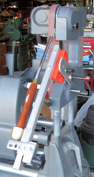

I found that the strip sander does not line up when reversed, by about 3/16”, but the coupling seems to still work ok. With the cover open and the belt throwing stuff upwards, eye protection is certainly needed.
[ATTACH]8990[/ATTACH]
I also made a few improvements to the sharpening attachment. The knob to set the angle is now on the right, and much easier to use. I changed the socket that accepts the butt end of a chisel to allow bigger ones.
[ATTACH]8991[/ATTACH]

prmindartmouth wrote:Well, I discovered one reason to run the strip sander in reverse. I was happily sharpening every chisel in sight and found that the hot sparks were melting a blister in my strip sander cover. See the photo below.
Peter,
Looks like you have discovered reason #2 for the sharpening platen.

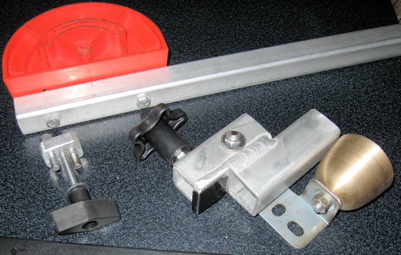

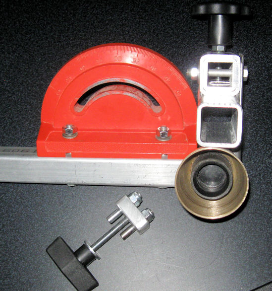

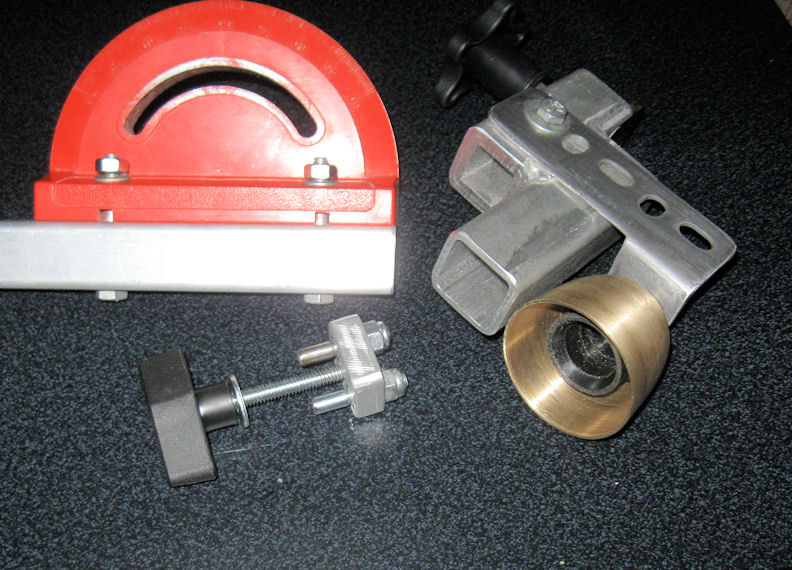

For anyone who might want to make their own version, here is a parts list with some comments:
Home Made Strip Sander Lathe Chisel Sharpening Attachment
miter gauge..................................1 3/4" deep by 5 1/2" plastic
Metal miter would be more rigid.
connection plate..........................6 5/8" x 2 1/2" x 1/4" aluminum plate
Use the semicircular mount off the ss to lay out the holes.
arm..............................................1" x 1" x 20" long al. tube
Would be better if 28" long for long chisels. (I made a removable extension)
slider............................................1 1/4" x 1 1/4" x 3" and 3 1/2" long pcs, welded
cup support..................................1 1/4" x 1 1/4" x 4" Dexion steel angle
cup................................................1 1/4" dia. black plastic in a 2" dia. brass cup
Suggest a 2" dia. wood cup with tapered center hole.
knobs............................................2 required
nut with posts allows knob on rt. side.......1/4" bolts with heads off in 1 1/4" x 1" x 1/2" al.edit fixed dim.
Set posts on arc of the miter gauge.
bolts...............................................all 1/4" x 20 tpi
[ATTACH]9006[/ATTACH]
[ATTACH]9007[/ATTACH]
[ATTACH]9008[/ATTACH]
