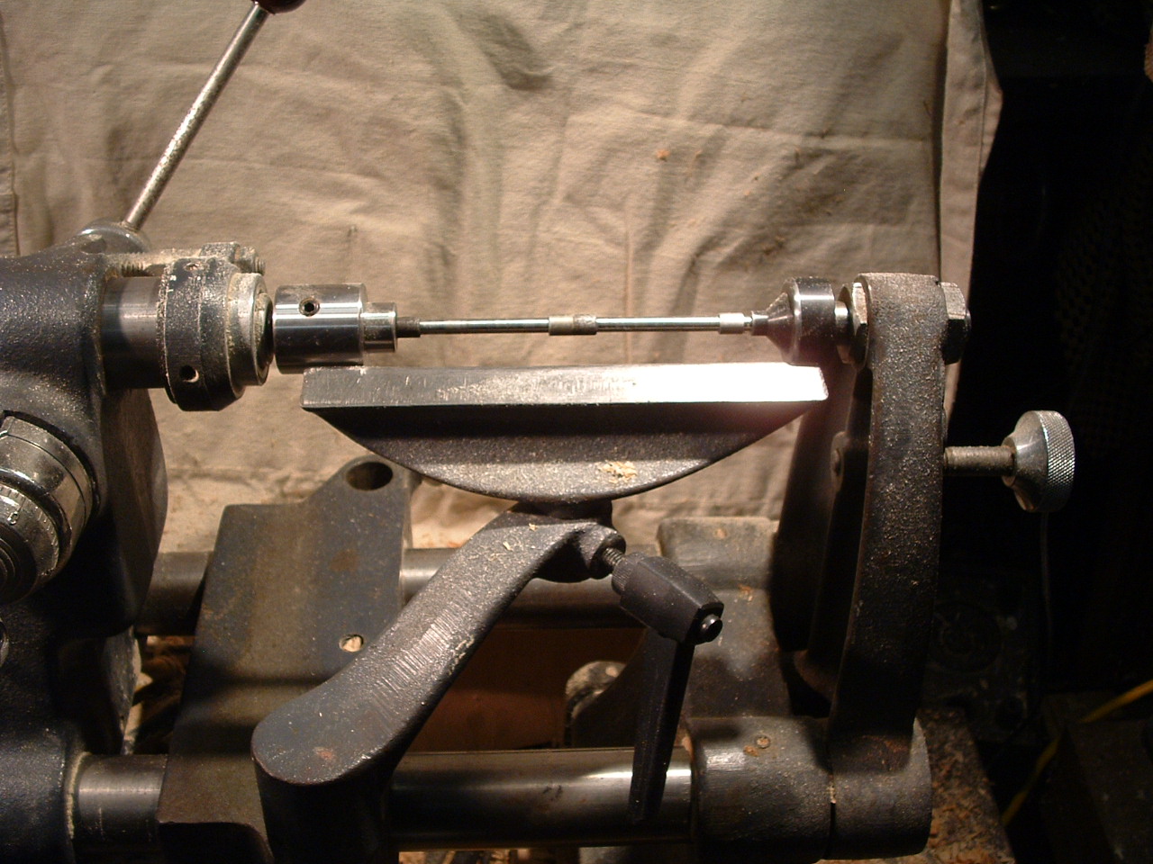

Push the carriage to the left, close to the headstock. If you need more space to get the tool rest where you want it you can extent the quill a bit. :)
Also, although the advise is to get the tool rest "as close as possible" to the work, it does not mean "almost touching", ;) Somewhere in the 1/4 to 3/4" range is fine, even a bit more if that is "as close as possible"..
This is set up with a pen mandrel, but you can see how the tool rest can extend past the sides of the drive and tailstock centers (live or dead)
