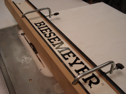

The T-slots are nice but they require each jig, fixture or aux fence have their own hardware. I have taken a modified approach. I saw a fence clamp made for biesmeyer fences and adapted it to my use.
[ATTACH]351[/ATTACH] http://www.grip-tite.com/
Here is a diagram of the clamp [ATTACH]352[/ATTACH]
Instead of being out of metal I built mine from wood and used a wooden dowel to insert into the jig, fixture, or aux fence.
I just glued some MDF (top piece and right side) and using a dowel (left side or piece that goes into the jig/fence) works just as well. For the tightening mechanism I simply used a generic t-nut and a bolt with a plastic knob on it.
I like this idea for two reasons
1. There is absolutely no metal anywhere near the blade. Even a huge oops doesn't allow metal to blade contact.
2. I built two and I can use the clamps on many different things. saving me having to have hardware for every jig/fixture/aux fence I want. All I need to do is drill a hole in the jig slide the dowel into it and tighten the clamp agains my fence.
Hi Ed,
This is a great idea! Maybe a little more $$ then I want to spend but adapting as you have would be a way to go. I have ideas sprouting in my mind as I'm typing this... Thanks for the posting!
