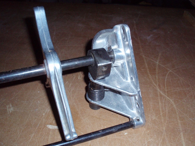

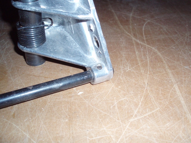

Are these the casters that are being discussed here. If so, the only thing that holds the entire assembly together as a caster set is the roll pin in the lower right of the attached photo and a second pin on the other side.
[ATTACH]10554[/ATTACH]
[ATTACH]10555[/ATTACH]
This is obviously the "old" style caster.

The newer style casters also use the roll pins on each end to hold the "assembly" together. The "upgrade" is the addition of a flat head screw in each end of the shaft that the cams are on. The screws go through the end castings into their respective ends of the shaft.
