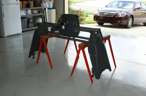

I just wanted to respond to Dusty's post about the caster problem. I almost tipped the machine over when I went to move it because the casters did not rotate to permit the wheels to roll. I first put the SS on some saw horse to raise the wheels up off the floor. Keep the machine close to one end of the horses.
[ATTACH]10526[/ATTACH]
Then roll the machine over so it is upside down and resting on the way tubes.
Then it is an easy matter to service all of the components of the caster assemblies and still stay off the floor. After two hip replacements last year laying down on a concrete floor is now problematic.

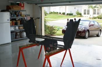

BY THE WAY, THIS CAN'T BE DONE WITH A LIFT ASSIST ATTACHED!!
[ATTACH]10527[/ATTACH]

- SS on saw horses.jpg (81.66 KiB) Viewed 3607 times
- SS upside down.jpg (67.34 KiB) Viewed 3598 times

Now that's worth the price of admission! I just used this to service the casters and take care of some rust on the legs. Also checked the leg bolts and bottom tube mounting bolts to make sure they were not loose. Great tip.wa2crk wrote:I just wanted to respond to Dusty's post about the caster problem. I almost tipped the machine over when I went to move it because the casters did not rotate to permit the wheels to roll. I first put the SS on some saw horse to raise the wheels up off the floor. Keep the machine close to one end of the horses.

This sawhorse tip is so great it makes me embarrassed that I picked most of mine up physically and laid them down on a big pad and worked on my knees back when I last did them.
Thinking about one with the lift assist, I wonder how it would work if you used ropes suspended (securely)
from the ceiling? I'm thinking of someone having the ceiling anchor points about 4' apart both ways. You could pass one end of each under the SS and back up to the ceiling anchor point and have the ropes holding the SS just off of the floor like the sawhorses do then just pivot the SS over upside down with it just slipping in the ropes.
Since I don't have a list assist I probably will not try it since the sawhorse method is so good.
