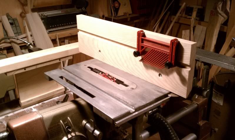

I finished up my featherboard equipped auxillary fence after work tonight. Planed to thickness, sanded, sawed the groove and drilled/countersunk the holes. This was an easy project that should be of great use. Dimensions are approx. 7.5" x 26.5" x 1.5". It's a nice hefty oak fence - any suggestions as to finish? Should I just leave it raw? I'm going to go back to PTWFE for the next jig /fixture project...
PTWFE aux. fence

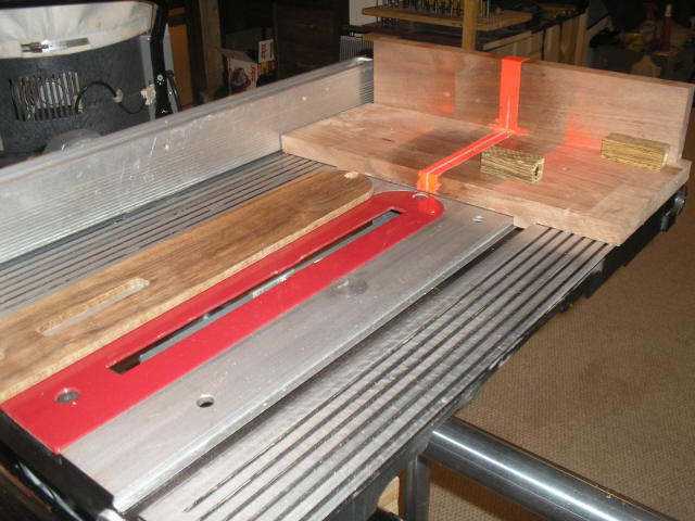

Hi again,
Showing some stuff together here.
A la PTWFE Fig. 2-11, I have a homemade zero clearance insert.
Also is a Small Parts Crosscut Sled.
For this sled, it also does a *super* job of letting me horizontal-bore my pen-blanks. I just nestle them against its fence-piece and clamp everything down tight.

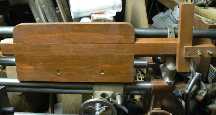

Cannot take credit for its creation(came with a used 510), but I did recondition it.
It was originally only stained(no finish). I rubbed it down with paste finishing wax(minwax) and buffed it out. It was 'stuck' (moisture) when I got it, but now it slides freely with very minimal 'slop'. Have not yet figgered out the reason for the wing nuts etc.
This jig may be found on page 84 of the 1984 'revised' edition of PTWFE.
[ATTACH]10551[/ATTACH]
It attaches to the fence and provides a vertical 'table' and 'miter gauge'(non adjustable angle.
Ignore the background etc.!:rolleyes:

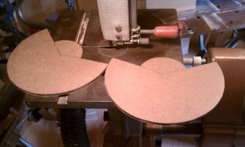

Saturdays in the shop - what could be better? Got started on the abrasive wheel guard - coming along nicely...
Cut the sides on the band saw from 1/4" masonite
Ripped the 3/4 braces from some sycamore with my new auxiliary fence
Trued up the sycamore clamping part up on the belt sander
Assembled with countersunk screws
I need to pick up some aluminum for the top of the guard and some allen head adjusting bolts for the clamp. Will post another pic when I'm done. Alec

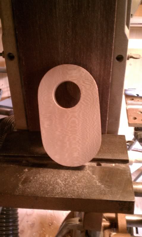

I finished the abrasive wheel guard. This project actually took more "tweeking" than I anticipated. Fitting the clamp was critical and there are no thickness dimensions in the plan. At first it was too thick, but I was able to sand it down to have adequate quill clearence and still enough room at the ends for the T-nuts. I pre-drilled the aluminum and used large stainless tacks for fasteners. They hold great and give it a nice finished look. Back to PTWFE for the next project! Alec
PTWFE abrasive and wire wheel guard
