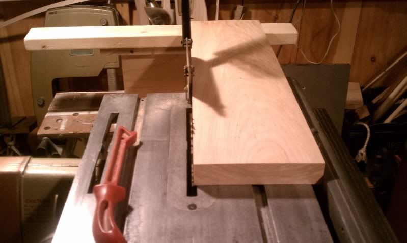

I began making my auxillary fence w/featherboard tonight. I am making it from white oak. I cut the stock to length, jointed one edge and then ripped to width and jointed the other edge. Tomorrow I will plane to the proper thickness, cut the groove for the featherboard and drill and countersink the holes for the carriage bolts. Here is a picture of the stock right after ripping to proper width. Note that I used my adjustable outfeed support - a 2x4 "T" support That is adjusted by positioning it in my Work-Mate table. More to come tomorrow! Alec

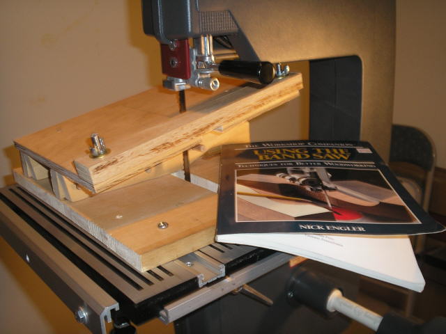

I thought -- SHIRLEY -- this was in PTWFE. But I believe it was from a Nick Engler book instead...
A dovetail cutting jig for the bandsaw:
[ATTACH]10536[/ATTACH]

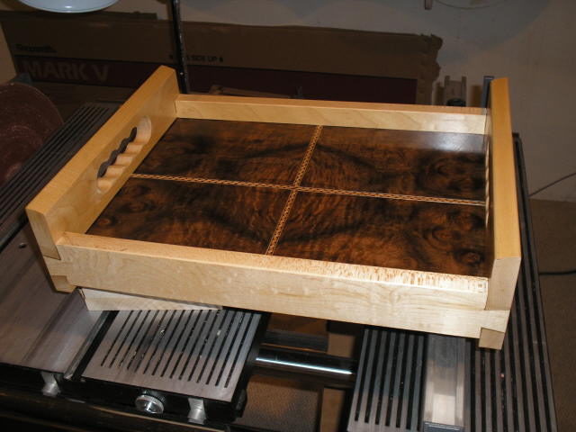

And a project done with it:
[ATTACH]10537[/ATTACH]
