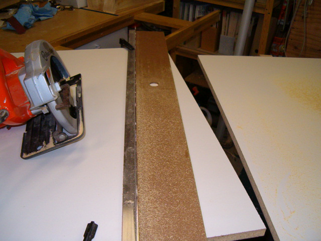

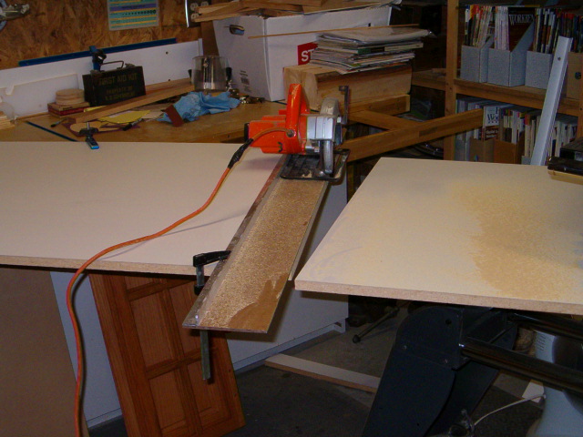

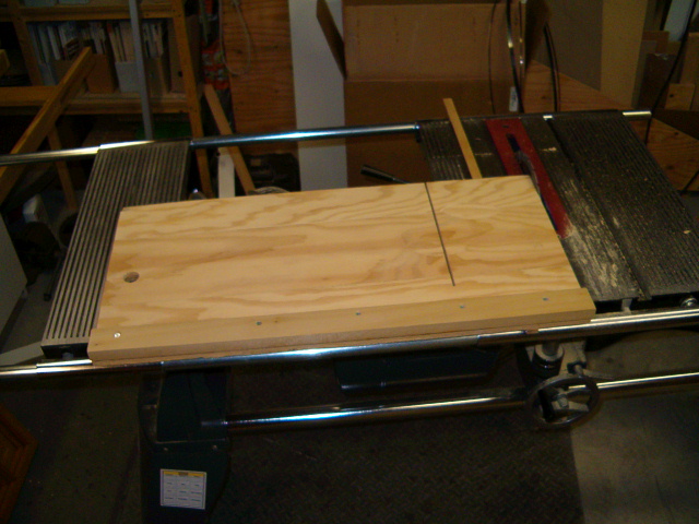

If there is a moral or lesson to this story (Thread), it is; If we attempt to saw off too large/heavy pieces of wood on our table saws using a rip fence, we are likely to have a "non-straight cut.
To avoid this issue - it is a better practice to first break down sheet goods to more manageable pieces. Then, if we want to use the table saw, use a sled. Sheet goods can be broken down quite well with a straight edge/circle saw guide.

Gotta use the best tool we have for the proper job. In my way of looking at the issue, the SS can be used for sawing large sheet goods only if there are two people and adequate rear support.
straight edge - circle saw.jpg (118.86 KiB) Viewed 7291 times
straight cutting guide.jpg (118.59 KiB) Viewed 7289 times
home made sled.jpg (143.5 KiB) Viewed 7286 times

Personally I have gone to Charlese's method and I now break down sheet goods before moving to the SS. The only difference here is I use a manufactured guide that gives me the effect of a zero clearance insert on my circular saw. The cut that is produced is so near perfect I can cut for exact size and don't have to recut them.
Ed in Tampa wrote:...Personally I have gone to Charlese's method and I now break down sheet goods before moving to the SS. The only difference here is I use a manufactured guide that gives me the effect of a zero clearance insert on my circular saw. The cut that is produced is so near perfect I can cut for exact size and don't have to recut them.
Thata boy Ed! Zero clearance is good! My homemade guide gives me a "zero clearance" effect in one side, while the cutoff side has to cope on it's own. The results are pretty darn good as you can see in the above pix. (cutting melamine) Does your manufactured guide have a "cover" on the outside of the blade?
Mine was made using a 3/4" aluminum angle screwed to a piece of hardboard, from below. The upright face of the angle had to be sawn off to allow clearance for the saw. This leaves an aluminum fence about 1/2" high to guide the saw, while the hardboard gets sawn off at the exact width of the saw base edge to the blade. I can lay the edge of the hardboard dead on the cut line, clamp the aluminum and zip - the line disappears and a straight cut appears. The only hard part is to reach across the width of the sheet. Sometimes this takes two operations - one pushing the saw as far as I can reach - the other , from the other side of the sheet , pulling the saw to finish the cut.
