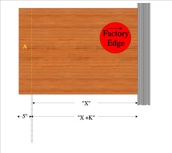

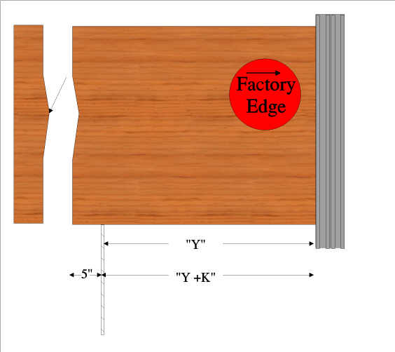

Hi,
When I got to this part of the post I got a little mixed up about how you are doing this. It seems that no matter what way you cut it you will end up with problems if the cut is not true. What turns out to be an extra amount on one piece is then a problem on the next piece... well you could joint between each cut but you didn't mention that.
So take a look below and tell me where my error in thinking is coming from. I made the error very large for the purpose of making this easy to see. I think by looking at the images it should be clear what I think is happening, but if you want I can add some more words later....
I somehow got the attachments in the wrong order so please look at them in the numbered order rip1, rip2, and then rip3... don't see a way to fix this with out deleting and uploading again???

Hi Ed,
I am sure that everyone can see where you are going with this but, I am sure that the other Ed would take the bad cut into consideration when remeasuring for his next strip, allowing more for waste. And of course, like you said, the waste amount would not be as much as your illustration shows.
