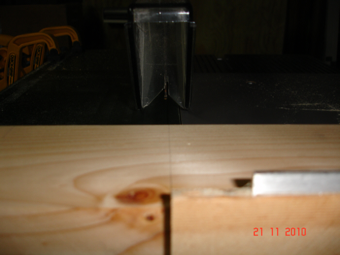

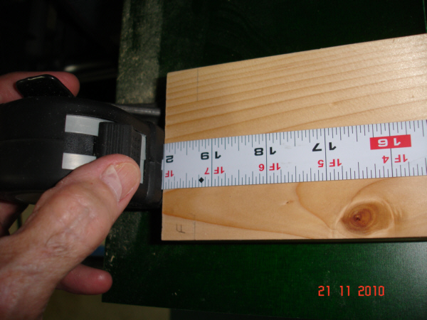

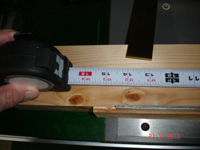

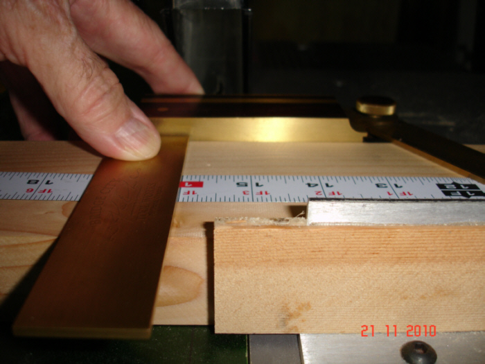

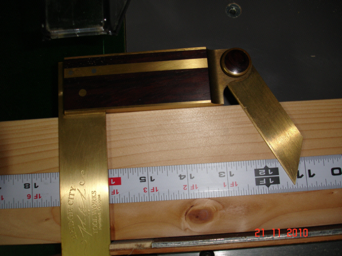

This may not help your current requirement, but it's new (to me) and pretty neat: ProCarpenter "Old Standby Flatback" 16 foot tape (details at fastcap.com). Inexpensive and loaded with features. Just been length-cutting a slew of 2x4s in groups of varying sizes. Using my SS sled with an add-on piece of wood to take the fence right up to the blade, put the 2x4 on it, run the tape from the right end (pre square-cut) up to the cut distance then put a square on the piece with the blade laying across the flat tape with its right edge on the measure needed, then slide the 2x4 with square and rule to the right til the blade touches the end of the sled's fence (which is the cut position). This done gently. Then while firmly holding the 2x4 down, remove square and tape and cut away. Perfect.
This is much easier than it sounds, quicker too. It works because of the flat tape and the very fine gradation markings on the tape, with the added benefit of not needing any pencil markings or transfers or whatever. The alignment to the saw blade is purely mechanical (square's blade touching fence cut-off edge).
In fact, maybe some pictures are in order...
31- pre setup, 2x4 to be cut to 16" length, tape, sled (sled fence attachment already run thru blade)]11000[/ATTACH]keakap wrote:...the flat tape and the very fine gradation markings on the tape, ...
