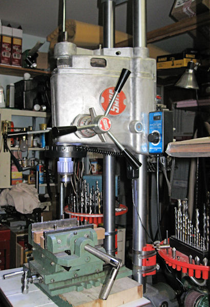

Just to note mods made today, the rectifier was moved onto the metal plate, seen here:
[ATTACH]11273[/ATTACH]

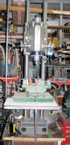

The clip was made again (3rd time) and allows the idler shaft to move in a bit more so that the belt is a little further from the casing. A brace was propped under the table so that a heavy 5" metal x-y vice could be used, primarily for drilling bits of metal. The vice is on a piece of 2x8 to get it up so the crank handles do not hit the table and the wood protects the aluminum table. A bottle jack is handy for raising the head, per Bill Mayo's setup, seen sitting under the table in this shot.
[ATTACH]11272[/ATTACH]
Here is the brace: (without it, the assembly sags somewhat from the weight of the vice)
[ATTACH]11271[/ATTACH]

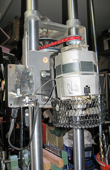

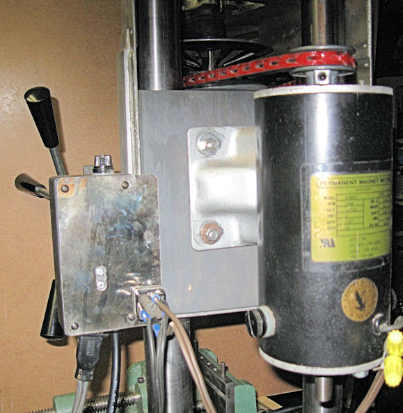

A Little Update:
Eleven months later and sure enough, the sparking at the brushes eventually carboned up the commutator of the dc motor and it quit. While looking into repairing it, I still have not run across a cheap treadmill to get a better control from, so I just replaced it for now with a different dc motor:
[ATTACH]14851[/ATTACH]
It has a cooling fan so I put a guard on made from the bottom of a waste basket from Value Village ($0.99). I also added a LED ring light at the quill (from Princess Auto), which gives great light and is transformer (wall wort) powered, so no batteries. See how it lights up the chuck area.
[ATTACH]14850[/ATTACH]
It is running smoothly and makes a super drill press but I still am looking for a treadmill.
