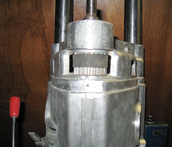

Very nice adaptation. The Gilmer appears to be riding high on the main shaft pulley. Try sliding the idler shaft into the headstock further(those clips are a pita and tend to cause you to mis-position the idler shaft(out)).
jpg, thanks for the advice and kind comment. I had not noticed the belt rubbing. Bill Mayo noted the same in a pm, so I took a look a few hours ago. The clips and bolt look like they were never removed, but came off after some careful wrenching. I tapped the idler shaft in a bit but the clips won't go on again, so I will make a new pair tomorrow, with the mounting hole moved a 1/16". This fix might cut down on some belt noise I hear too. I found some good info in this post:
http://www.shopsmith.net/forums/showthr ... t+tracking
Peter
At first I thought Bill was bonkers re removing the clips. I now know he was correct. My experience with the sand cast headstocks is that the clips do NOT position the idlershaft far enough into the headstock to align the belt properly-same thing if a poly-v belt is being used.prmindartmouth wrote:jpg, thanks for the advice and kind comment. I had not noticed the belt rubbing. Bill Mayo noted the same in a pm, so I took a look a few hours ago. The clips and bolt look like they were never removed, but came off after some careful wrenching. I tapped the idler shaft in a bit but the clips won't go on again, so I will make a new pair tomorrow, with the mounting hole moved a 1/16". This fix might cut down on some belt noise I hear too. I found some good info in this post:
https://forum.shopsmith.com/viewtopic.php?t=5240&page=2&highlight=Gilmer+belt+tracking
I could not wait so I made a new clip, about as thick as two of the originals and carefully tightened the bolt through the ears. WOW, what a difference. The drill is running very smoothly now. Thanks for your advice. I will keep an eye on the idler shaft to check if it is creeping out. Here is a picture showing the belt running further from the casing:
[ATTACH]11248[/ATTACH]

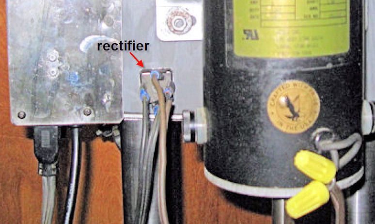

Electrical
Can you explain the electrical portion of this setup? I see the router speed control, but what is a rectifier and where is it located. It looks like a great setup.
ctxman, Thanks for your question. I am not an electrician so use at your own risk. My understanding is that the router speed control only controls a motor having brushes. It puts out ac , so to run a dc treadmill motor, the output is connected to the rectifier, which converts ac to dc. The rectifier is located here:
[ATTACH]11261[/ATTACH]
It is held to the plywood by a central screw. It will be better for heat disipation when I move it to the metal plate that mounts the speed control.
So, the electrical path is router speed control to rectifier to dc motor. My setup works ok but seems hard on the brushes ( some sparking). I used what I had available, but I am looking out for a cheap treadmill with a good properly designed controller board and motor to use instead.
- rectifier location.jpg (82.54 KiB) Viewed 14651 times
