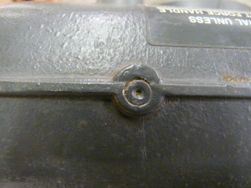

The quill has never been pulled on this machine.
[ATTACH]11872[/ATTACH]

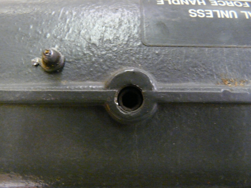

You have to dig out the plug to access the set screw.
[ATTACH]11873[/ATTACH]

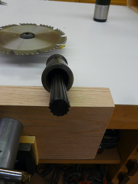

Man that is one clean quill.

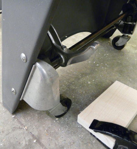

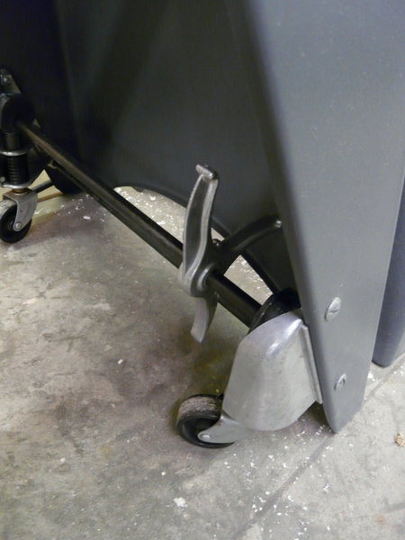

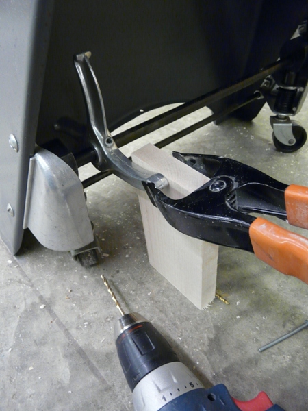

Got every thing back together lubed and waxed. The casters however had to be as Farmer put it Built on a Friday after a liquid lunch.
[ATTACH]11876[/ATTACH]
I re-aligned all the cams and the foot levers but when I got the machine back together I discovered that the flat areas for the set screws and the holes for the split pins to hold the foot levers were not jiving. Something was off several degrees.
[ATTACH]11877[/ATTACH]
My solution was to drill new holes for the foot levers.
[ATTACH]11878[/ATTACH]
More better. Just in reach of my # 12's.

mbcabinetmaker
- Posts: 1627
- Location: Greer SC
Is it possible the cams were on backwards??? That and the crank backwards or upside down and 180 out is about all that be mis-assembled(assuming the roll pin holes are back mating the original end casting they were removed from!). Oh and the crank on the correct end(later models have holes drilled in both ends).mbcabinetmaker wrote:Got every thing back together lubed and waxed. The casters however had to be as Farmer put it Built on a Friday after a liquid lunch.

JPG40504 wrote:Is it possible the cams were on backwards??? That and the crank backwards or upside down and 180 out is about all that be mis-assembled(assuming the roll pin holes are back mating the original end casting they were removed from!). Oh and the crank on the correct end(later models have holes drilled in both ends).
HEHEHEHE! I was thinking the very same thing as I had a little brain fade when i went to put my VII casters back together. I looked at them and got them all back together only to find that they were backwards. break out the hammer and pin punch again and all was well in the Shopsmith universe.

First time I 'reassembled' one of these I did not get it right the first time. I have learned to 'dry' assemble it(no roll pins)(short nails) and verify all parts orientation re proper operation b4 driving them in!wannabewoodworker wrote:HEHEHEHE! I was thinking the very same thing as I had a little brain fade when i went to put my VII casters back together. I looked at them and got them all back together only to find that they were backwards. break out the hammer and pin punch again and all was well in the Shopsmith universe.
