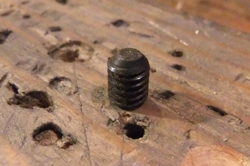

SO ARE THE SET SCREWS USED TODAY ANY DIFFERENT FROM THE ONE'S IN THE 50'S, ESPECIALLY PERTAINING TO THE TUBES? Surely someone with a vintage SS and a new SS can answer this question. I know some of the set screws I have ordered were not the same as the ones I was replcaing but I haven't ordered any for the tailstock eccentric or the tubes.
Of the set screws that mate with the tubes (way and bench) all of mine are serrated. Two different vintages but both newer than the plaintiffs.ddvann79 wrote:If indeed the issue was with the tailstock moving away from the rest of the machine, it could simply be a way to reference the machine generally coming off the tubes. It could be that the tailstock end is what slipped. It could also be that the tailstock was being used to turn the chalice if he was roughing it in and had not starting end turning yet.
Ah Ha! Now we are getting somewhere.dusty wrote:Of the set screws that mate with the tubes (way and bench) all of mine are serrated. Two different vintages but both newer than the plaintiffs.
This is what the set screws for my way tubes look like. Any cause for concern? As far as I know, the bench tubes are only held in place with the tube lock bar so it doesn't make sense that set screws would come loose here. Did I also hear someone say the set screws were visible from the top of the tubes?
[ATTACH]12144[/ATTACH]
