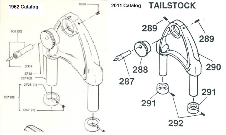

1. If the machine was purchased in 1955 and the "necessary attachments" for using it as a lathe were purchased in 1957, I assume these attachments were not the standard spur center and dead cup center that came with the machine. Does anyone know which lathe attachments were being used and if they are cause for concern?
[INDENT]The opinion also states, "Plaintiff introduced substantial evidence that his injuries were caused by defective design and construction of the Shopsmith. His expert witnesses testified that inadequate set screws were used to hold parts of the machine together so that normal vibration caused the tailstock of the lathe to move away from the piece of wood being turned permitting it to fly out of the lathe. They also testified that there were other more positive ways of fastening the parts of the machine together, the use of which would have prevented the accident. [/INDENT]
2. How could the tailstock "move away from the piece of wood" in normal use? My initial thought was that the center was not sufficiently seated into the work or tailstock. And also, what set screws are present in the tailstock that would allow for this motion? The only one I am aware of is the setscrew that holds the eccentric in position. This could potentially come loose, allow the eccentric to rotate and lose grip on the workpiece. If that is the case, it sounds like user carelessness. I noticed my 1962 tailstock has only one set screw to hold the eccentric, while today's tailstock has two. The collars also have set screws. Are they any different?
[ATTACH]12112[/ATTACH]
3. What are the "other more positive ways of fastening the parts of the machine together" that would make the lathe operation safer? For you turners out there, is there tailstock equipment that you prefer to use that would make it safer?
4. Are the modern cupped set screws better/safer than the old blunt set screws? The part number of the modern eccentric set crews is much higher than the 1058 PN in the 1962 parts list.
I suppose what I'm really asking is, what are some reasonable steps I can take to make the lathe safer? After reading this court case opinion, a sturdy face shield or mounted shield sounds like a good idea. PLEASE, let's focus on these questions of mechanics, NOT how our courts have gone bad or how lawyers have run companies out of business, at least at first. :)

I think that the setscrews that loosened were the ones on the way tubes. So these are the ones I would check. I found that after 30 years mine had loosened, when I noticed that the tail stock was not holding alignment.

MikeG wrote:I think that the setscrews that loosened were the ones on the way tubes. So these are the ones I would check. I found that after 30 years mine had loosened, when I noticed that the tail stock was not holding alignment.
Good thought. Of the couple of dozen + that I bought when I was acquiring most seemed to be one extreme or the other. Some were so tight that it about took dynamite to get them loose. A shocking number of others were so loose that you could just slip the tubes out of the sockets without even using the wrench.
Some of the bench tube clamps had been over-tightened so bad that the ends of the tubes were crushed out of round. I don't recall any of those being too loose though.
The stop collars do very little, if anything, to secure the tailstock. The set screws (291) secure the stop collar for height adjustment. The other setscrews (289) secure the eccentric rotation.
Yes, you can develop a scenario where something moves and the work piece becomes loose as a result. I don't see that scenario, though, to be the equipment manufacturers fault.
Does the operator have any responsibility at all? It does now seem like it when you listen to these cases.
Now the headstock lock might not have been secure and if it moved the work piece could come loose but, again, is that the manufacturer's fault.
I don't really turn so there is not much more I can add to these discussion.
As I understand it, the way tube set screws came loose allowing the end casting to move outward causing the 'chalice' to fly off the tailstock center.
The damning detail was that Yuba Power Products (or the salesperson who sold it to his wife) extolled the safety of the shopsmith and assured her it was 'safe'. Had that not been the case I do not think the case would have been decided as it was. I believe the 'guilt' lay in the assertion of its being safe and the inadequate performance of assuring that degree of safety.
It disturbs me that as Farmer has noted there are still a lot of 'loose' setscrews including some that were not ever tightened(indicated by lack of marking by the end of the setscrew on the tube).

From the parts diagram, it appears that the pin on the dead center is removable - perhaps that is the piece that came loose?

OK. It may have been the set screws on the tubes, but from 1955 to 1957? Just two years? Hmmmm. So I suppose no one is familiar with this case. After reading several other briefs and summaries of the case, the tube hypothesis seems plausible.
But the original questions remain. Are the setscrews different? Are they safer today? Is there other equipment that provides more "positive" assembly?
