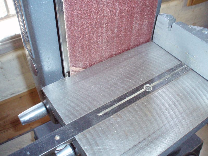

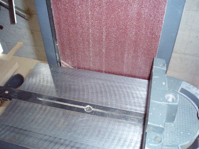

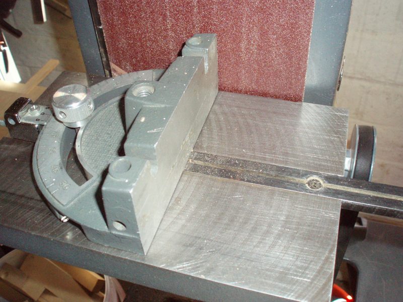

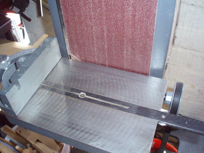

So far so good. He had the screw. The washers are thinner, but two of them are perfect. Now I'm going to try to put a countersink in one of them to accomodate the screw head. We'll see what happens.
Total cost so far - 36 cents, including tax, not including gasoline for 6 miles round trip.
(Yes, I took the miter bar with me. Good thing too.)
I'm guessing that's so you could use that in any track or slot that does't allow for the "wings" of the washer sticking out beyond the bar sides. Seems like a good idea even though I don't think I have anything right now where that is need.dusty wrote:Put Flats on the Sides? Why? Where do you find that this might be useful other than on the Belt Sander Table?
Cheers.
Hal
That is my point, Hal. The only place that I am inclined to use the miter gauge that does not facilitate the washer is the table on the Belt Sander and it is only about 8" long.
It is a neat idea but (for me) has no utility since the miter gauge can not be used on any non-Shopsmith equipment because of bar width.

dusty wrote:That is my point, Hal. The only place that I am inclined to use the miter gauge that does not facilitate the washer is the table on the Belt Sander and it is only about 8" long.

Point well made Dusty! But some of us have old ancient versions of things like Mark 5 worktable, CI bandsaw tables and home made jigs that were created b4 the newer slots were created. As a result I have removed the washer from the gauge until I get the 510 on line. Since the 510 table has no way to extend the infeed end of the slot, I predict I will need it for wider crosscutting.
The double d shaped washer was a suggestion for anyone having to use a single miter gauge on both old and newer slots.
