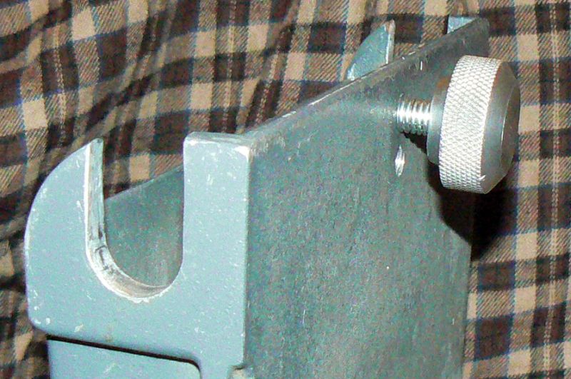

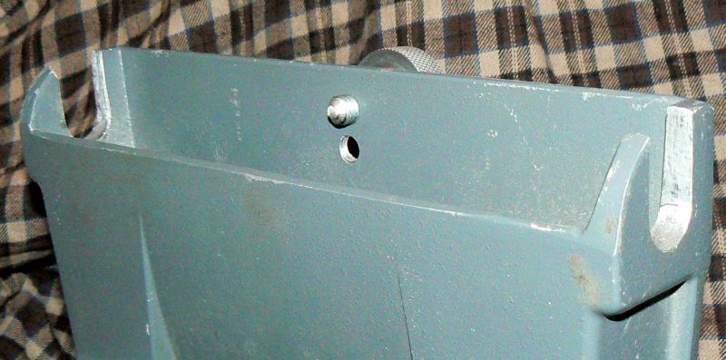

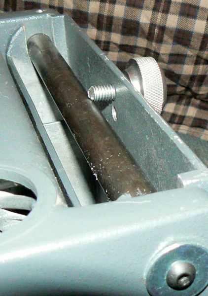

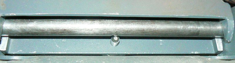

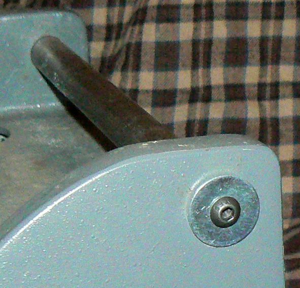

Double tilt phase 2
Made a few 'alterations' to an end casting.
[ATTACH]12494[/ATTACH]
[ATTACH]12495[/ATTACH]
Knob is a damaged 10E with new screw inserted.
[ATTACH]12496[/ATTACH]
Hinge pin drilled/tapped 1/4-20, ftat washer and screw(5/32) hex.
[ATTACH]12497[/ATTACH]
[ATTACH]12498[/ATTACH]
The casting wall is thin, I will add a tapped plate to beef it up.
Less said about the 'extra' hole the better!:rolleyes: It will secure the beef plate!:D
