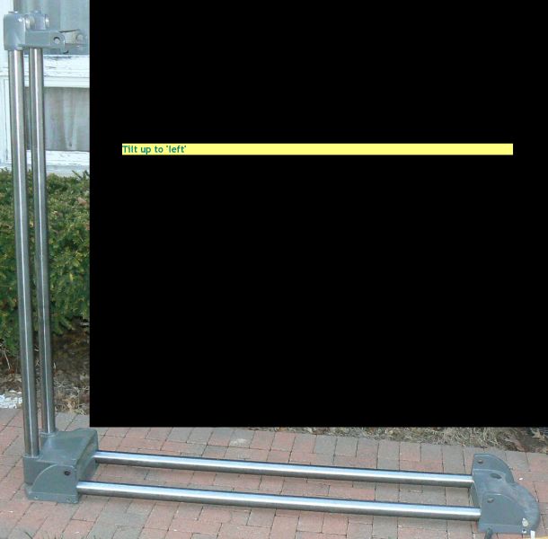

Took time today to do some 'experimenting'. Since the introduction of the Mark 7 discussion has taken place re retrofitting a Mark 5/V so as to allow tilting both ways.

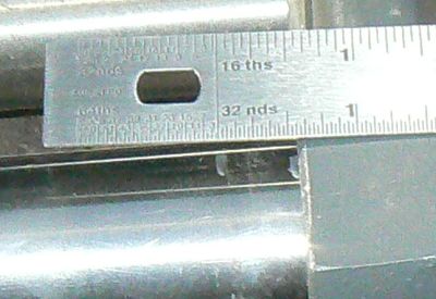

I assembled two hinged end castings and 4 tubes. The bench tubes were installed as usual(end butted up against the 'stop'). The way tubes were then installed and the result was that the way tubes fell short of the stops by about 5/8"
[ATTACH]12347[/ATTACH]
I split the difference at both ends(5/16 short of their stops).

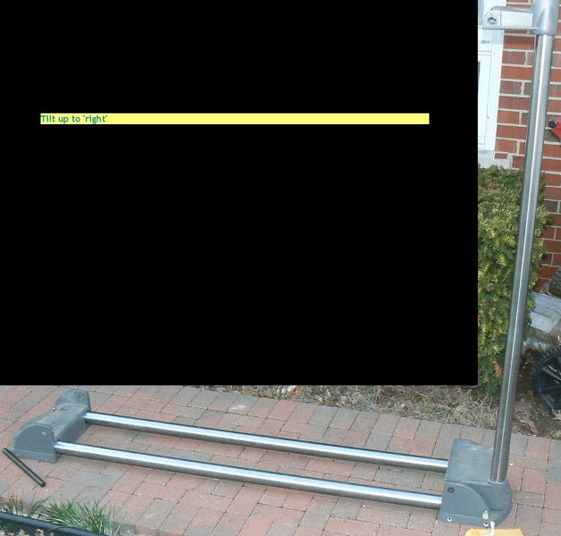

By pulling the hinge pin at either end, It can be tilted at the other.
[ATTACH]12348[/ATTACH][ATTACH]12349[/ATTACH]

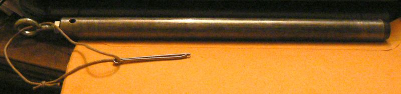

Kinda difficult pushing the hinge pins - so - proposed alteration.
[ATTACH]12350[/ATTACH]

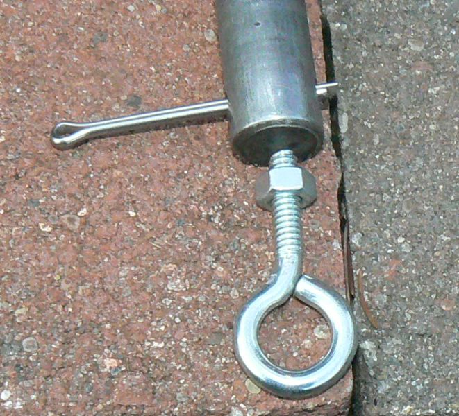

After drilling and tapping hole in end of hinge pin and forming the cotterpin so as to make it captive
[ATTACH]12351[/ATTACH]
This works even though I did not 'adjust the tubes' for perfect alignment.
A little bit of wiggling the way tubes as installing the hinge pin is required, but if the casting had stops to rest on that would not be required.

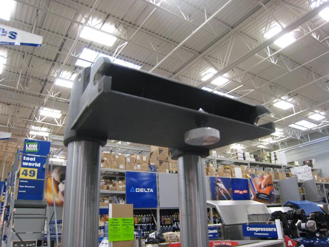

I thought the following shows what Shopsmith did:[ATTACH]12353[/ATTACH]I have been tempted to modify a couple of arms but just have not gotten around to it.damagi wrote:I think you are close. One thing to consider would be to see if there was some sort of replacement for the hinge pin that was the correct diameter but longer. That is what shopsmith did...adding the pins on the outside of the castings. Granted, they were using spring pins because the hinge pin didn't get removed, but the concept is the same.

I am guessing since the retaining 'screw' binds the pin. they wanted it to rotate in the outer holes, thus requiring removing the pin which keeps the pin from rotating. It used to be the inner casting rotated on the pin. Tis a better design both for assembly and repair!
