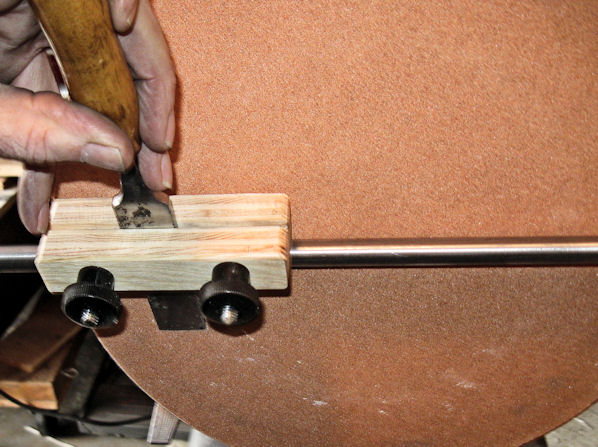

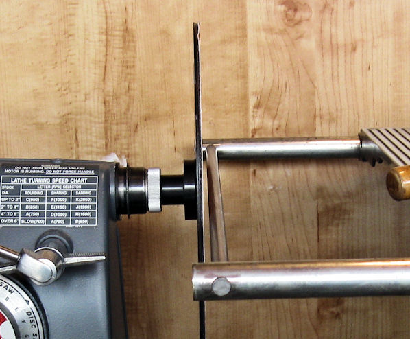

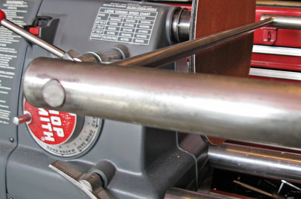

If you have a 510 it is fairly easy to follow up on Ed and JPG's comments. I have a couple of scarred up extension tubes that I did not mind drilling holes in. I drilled a 1/2" hole about 1 1/4" back from the ends to mount the 1/2" guide rod as seen here:
[ATTACH]12515[/ATTACH]
[ATTACH]12516[/ATTACH]
The guide rod is just a snug fit in the tubes. To set it up, I extended the quill an inch or so and locked it. I then installed the two tubes with the guide rod and brought the rod against the sanding disk to ensure the rod is parallel the face of the disk. The tubes were then locked in position and the quill taken back 1/4" and locked as well. It makes a pretty ridgid assembly. You have to be careful not to sand your knuckles, but this setup is simple, easy to store and works just fine. I would recommend it over the drill press version. Evolution of design..........thanks for the ideas guys!
[ATTACH]12517[/ATTACH]
You will still need the bevel gauge and tool clamp from the Shopnotes article, to set the 20 or 25 or 30 degree bevels on your chisel or plane iron.

What/Why makes the 3/4" spacing of the rod 'above' the disk important? Could not positioning the chisel in the holder control the angle? The angle depends upon both!
Neat solution! I have to rethink my approach. I made some clamps and blocks that get secured to the Main Table (at the left edge) and worked off the table edge.prmindartmouth wrote:If you have a 510 it is fairly easy to follow up on Ed and JPG's comments. I have a couple of scarred up extension tubes that I did not mind drilling holes in. I drilled a 1/2" hole about 1 1/4" back from the ends to mount the 1/2" guide rod as seen here:

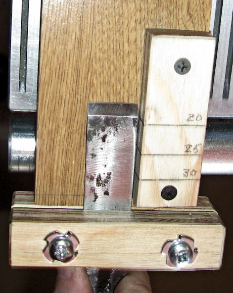

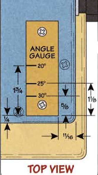

JPG, you are right but if you want to use the bevel gauge from the article, you have to stick to the author's geometry. He matches the top of the bevel on the chisel with the line on the guide.
[ATTACH]12524[/ATTACH]
edited to correct a typo

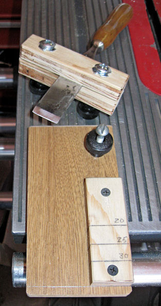

Just to beat this item totally to death, here is the above bevel gauge mounted on a little board that is clamped to a table slot using a SS t nut:
[ATTACH]12623[/ATTACH]
This view shows the nut:
[ATTACH]12624[/ATTACH]
The rather poor chisel is clamped up with the top of its bevel even with the degree line as seen here. Please ignore the parallax in the photo:
[ATTACH]12625[/ATTACH]
