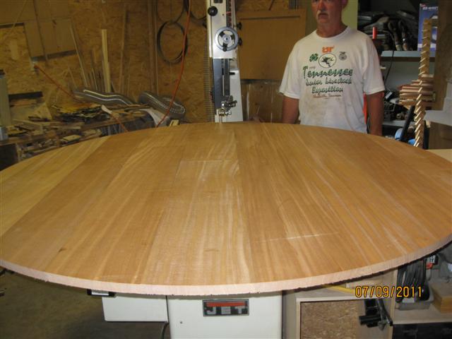

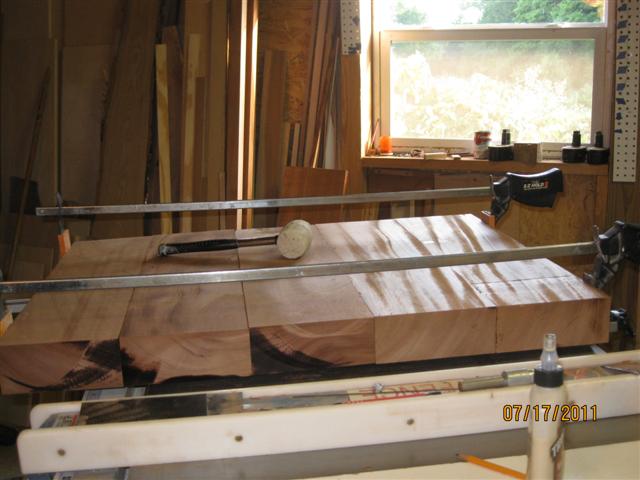

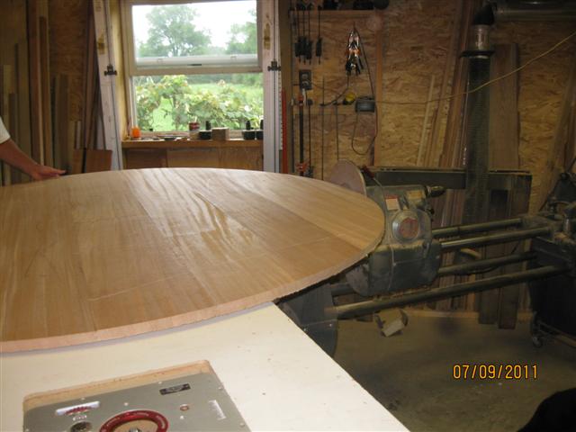

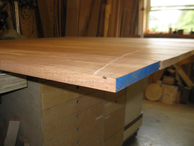

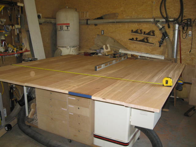

This was a fun and challenging project. These pics will show the steps I took to ensure an almost perfectly balanced blank before it went on the lathe.
I used a rail and stile bit combo to create a stronger edge joint and ensure better alignment for the blank. My table saw insert was turned into a pivot for the blank by attaching a bolt thru a scrap piece of plywood and inserting it into a hole in the insert. The blank was attached to the plywood using double stick tape and required a chisel to separate when done. This worked well enough that the round blank could be spun like a lazy susan.

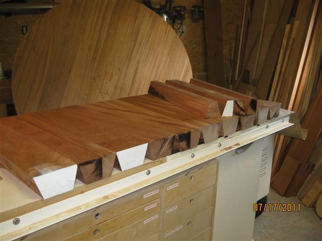

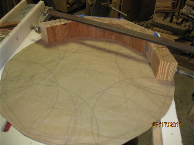

More pics

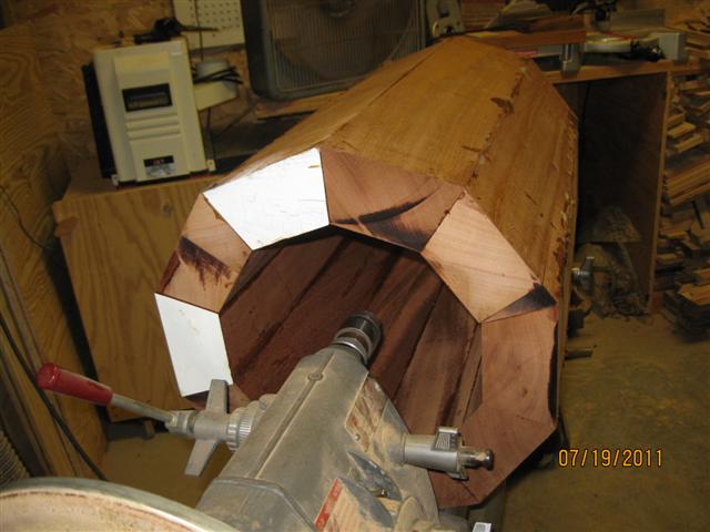

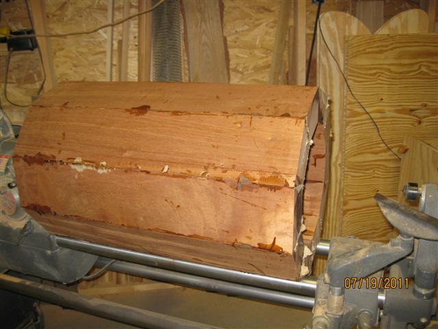

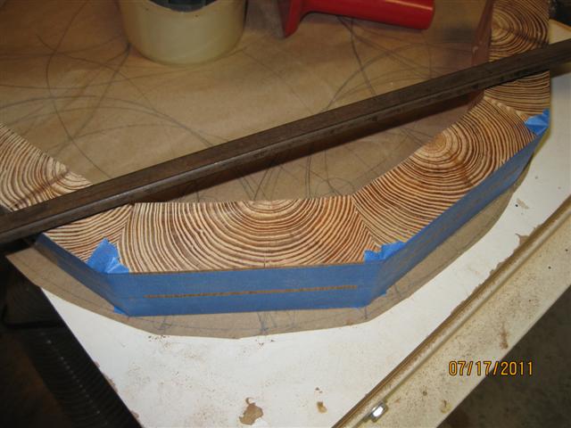

The glued blank fit the pattern from the wikipedia decagon trick as well as the test cuts did in the Angle 1 pic. After gluing I thought I was off on the blank and set it on the pattern to check. It looked like I had traced around the blank it fit so well.

- 9-PRE-GLUE STAVES.jpg (41.21 KiB) Viewed 2079 times
- 10-POST-GLUE.jpg (49.25 KiB) Viewed 2085 times
More pics

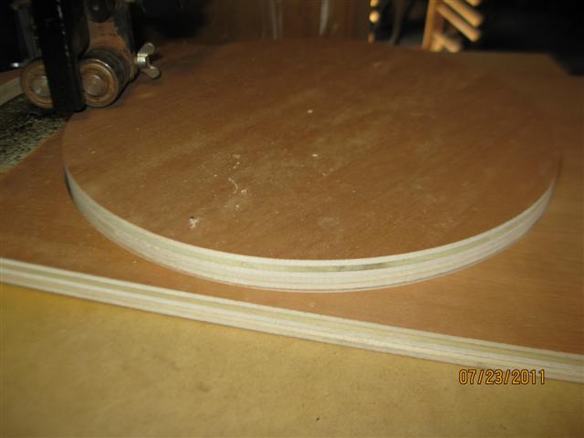

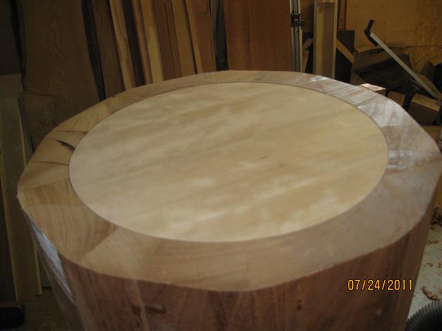

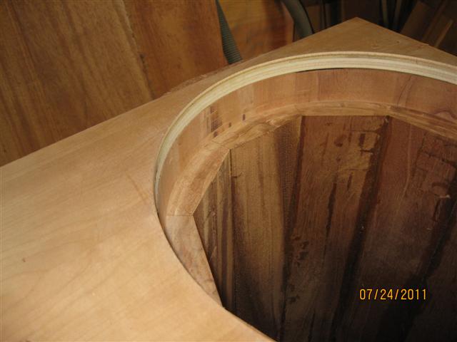

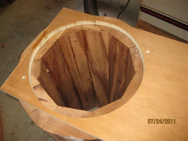

By off setting the bottom blank and double stick taping the blanks together I was able to cut identical circles leaving waste on all sides of one blank. I drilled a hole thru both blanks before placing on the pivot point of my circle cutting jig. This was essential to centering the blank for all future steps. I rabbetted the end caps into the blank for extra strength and to save inches on the SS.
- 11-POST-GLUE2.jpg (45.99 KiB) Viewed 2083 times
- 12-CUTTING CIRLES.jpg (30.76 KiB) Viewed 2089 times

- 14-RABBET IN STAVE.jpg (36.02 KiB) Viewed 2084 times
- 15-NICE FIT.jpg (30.3 KiB) Viewed 2094 times
