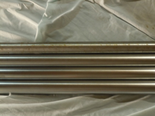

I got around to cleaning the tubes on the SS about a week ago. Have been working pretty slow as most of my time has been spent unpacking and getting some things done around the house from our move earlier in the month.
Here is a pic of 3 of the tubes that are "after" de-rusting them alongside one tube that I hadn't touched yet. Quite an improvement I thought. Sometimes you don't realize how bad something is getting until you see it all cleaned up.

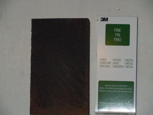

When buying some supplies at Lowe's, I found this sanding pad near the sand paper. It worked quite well, plus it can be used wet or dry. I think I might take the sandpaper I purchased back as this cleaned up the tubes quite nicely.
[ATTACH]13477[/ATTACH]

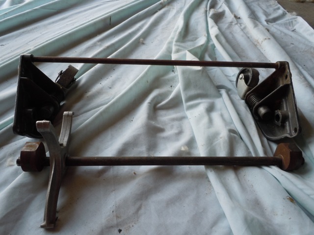

Alright, my next question for those of you who have done this before. I was working on disassembling the wheel assemblies. I removed the bar with the rise/lower foot lever, but how do you remove the lower bar (Shown in the picture)? There is a little hole on each end with what look to be hollow pins connecting the bar to the gray leg pieces? Is there any way to get these apart? I might try using the gray pad above to remove the rust on these pieces, but if that is not sufficient then will probably try evaporust.....unless someone has a better suggestion.
[ATTACH]13478[/ATTACH]

You need the appropriate size pin punch to drive the roll pin through. The right size punch will fit neatly in the holes you are driving the pin through.
Rob in San Diego
You can save yourself some later frustration if you mark each 'lower' rod(both ends) so that when reassembling, the same ends of the rods go into the same holes in the same castings. They are drilled at assembly, and often vary to the point of not fitting other combinations. I dimple 0 to 3 marks on the ends of the tierods(lower) and on the castings near the hole.
FWIW I usually remove the lower rods FIRST. Removing the crank is done by again driving the tension pin out. You may need to use a smaller pin punch to get it through the shaft. Those pins can be stubborn to get started. In any event, do NOT booger the ends.
Also some pix prior to disassembly will help when reassembling. Only the castings are left/right pairs. All other left caster/right caster variations are the result of different orientation of parts that are the same. All cams, all crankshaft, all tierods, all cranks all pistons, all springs, all retaining clips are the same. Location of holes in the crank shaft is important.
There is one correct combination, many not so!:eek:

I don't have a pin punch set. Is there any alternative tool to use that can work that would save me from having to go out and buy a pin punch set?
I'm not that cheap.....just purchased our first house and are really trying to watch what we spend right now.
1981 Mark V, bought used in Feb. 2011
pessen wrote:I don't have a pin punch set. Is there any alternative tool to use that can work that would save me from having to go out and buy a pin punch set?
Try a correctly sized common nail. They are soft and prone to bending. File the end flat that pushes the tension pin.
P.S. There are variations. Some have pinned cams rather than set screws. The tierod and crank shaft tension pins have a different diameter.
