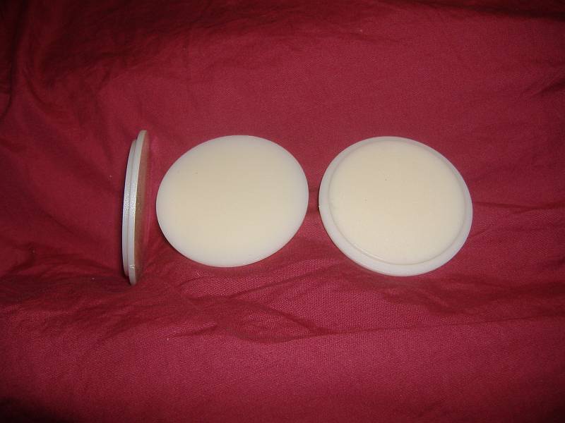

Busy week but not much of that time was spent on the bandsaw. I did get the plastic table inserts order in. The word snap should not be in the description, as there is no "snap". The insert does fit the hole and as such is a drop in.
There is no means by which to insure the insert will not turn... not sure I like that. I guess maybe a small modification will be in order once I get to that point of attempting to use them.
I did take one picture of the three which might help you in understand what you get:
[ATTACH]13775[/ATTACH]

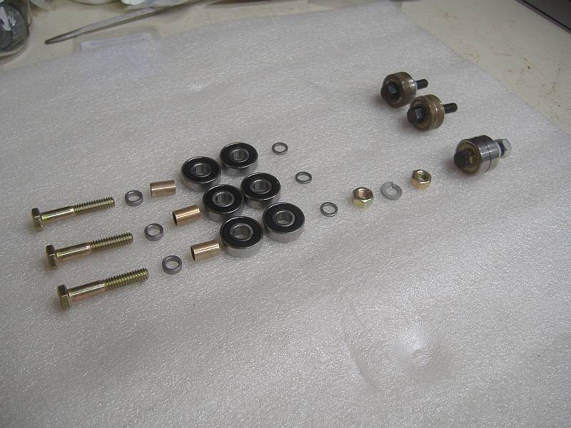

I thought I would do at least this simple post on the dual bearings that I added. First a picture of the "parts"
[ATTACH]13776[/ATTACH]

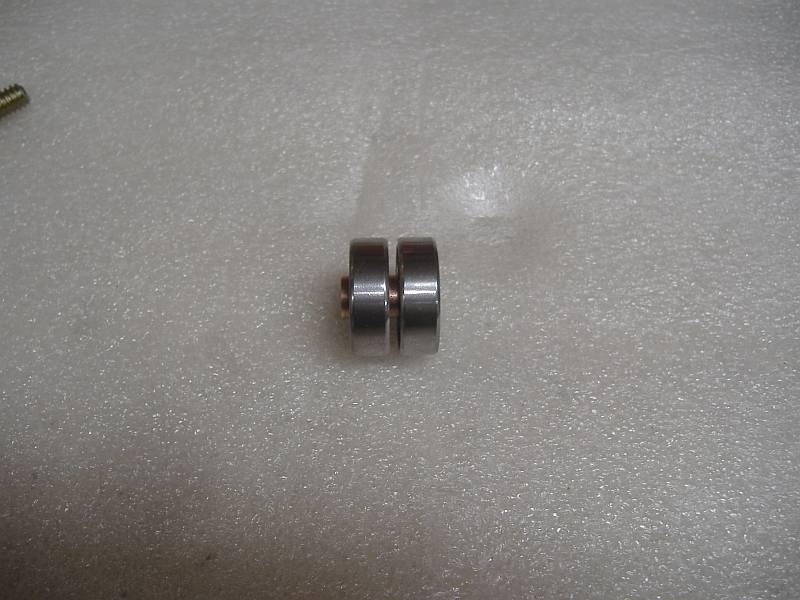

As you put the bushing in the bearings you might find that they are not quite fitting together like they should. This picture shows one bearing not flush with the bushing and the second bearing both not on the bushing and not adjacent to the other bearing.
[ATTACH]13777[/ATTACH]

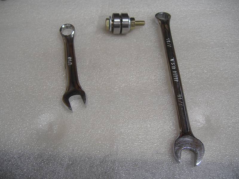

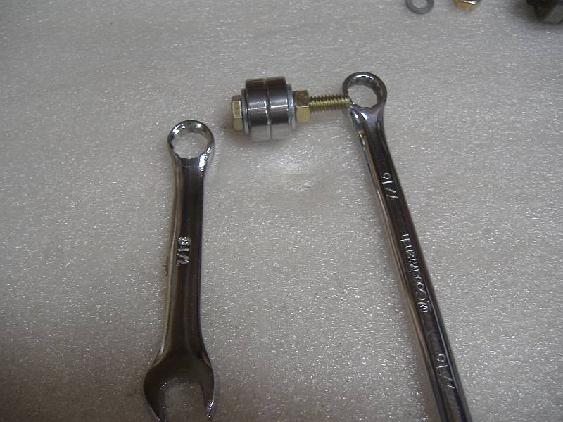

There are many ways to "fix" this, I opted to use a bolt, flat washer on first, then the bushing with bearings on, followed by a second flat washer then a nut. The flat washers make sure you not putting pressure in places you don't want to... the bolt head and nut would also work but I elected to add the washers because I've need to do this several time and like the contact area of the washer isolating load.
[ATTACH]13778[/ATTACH]
This should take very little force so a pair of wrenches does very well.
[ATTACH]13779[/ATTACH]
