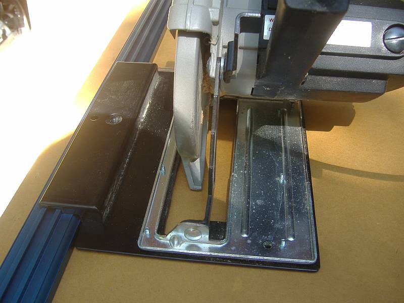

dusty wrote:I was embarrassed when I realized I had this hanging on the wall and hardly ever used it. It was a gift from one of my daughters and I had none of the accessories. When the saw track discussion arose, I did some research and discovered that there was a saw plate available. I when to Woodworkers Source and got one.
I have the 54" model (U54) so it is not useful for ripping 8' sheets. I will probably solve that with a U99.

The profile of my rail is a lot different than yours and would facilitate a saw plate that rode up top rather than along side. BUT, that is not the way the plate is built.
My plate also functions as a zero clearance devise. (Maybe I mounted the saw wrong.)
Your plate mounts different than mine. The blade is closer to the guide than on mine. Did you re-drill the plate so that you could mount it that way.reible wrote:Dusty that looks like a nice gift your daughter got you. It is different then mine, I don't think they had your style when I got mine.

Yours appears that it would be more stable than mine.

I've posted several picture of the plate, does that too look like yours?
Perhaps a phone call or email to them could clear this up. Or even just order the plate and see if it fits, assuming it can be returned if it doesn't.

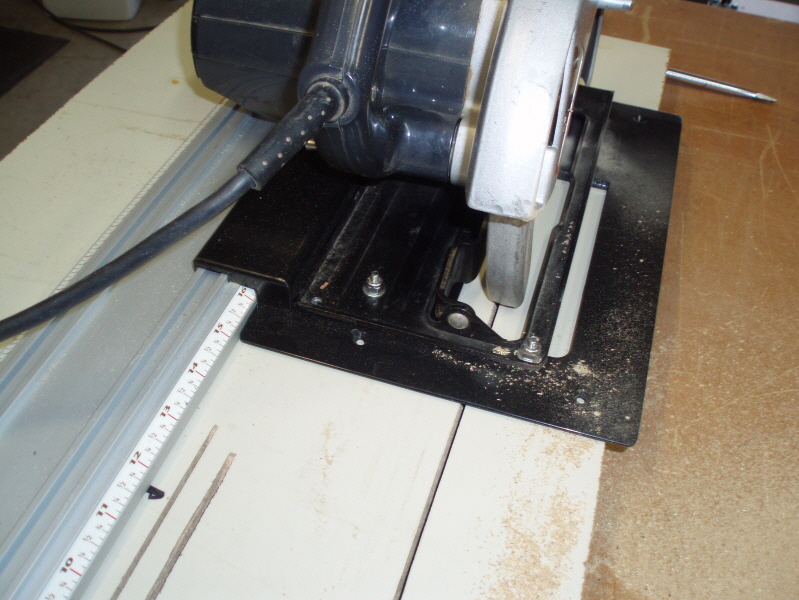

Here is what mine look like

I think from looking at your pictures the motor of your saw is over the hump in the track, on mine it is the other way.

I have no idea which is right or wrong or maybe there is not right or wrong?

dusty wrote:Your plate mounts different than mine. The blade is closer to the guide than on mine. Did you re-drill the plate so that you could mount it that way.

It is ready for use so I am not going to change it for the time being. I don't believe it is a case of right or wrong - just different. My plate is not drilled so that it could be rotated - besides, it was assembled when I got it.reible wrote:I think from looking at your pictures the motor of your saw is over the hump in the track, on mine it is the other way.

I thought maybe you had redrilled yours.

When I bought my saw plate (yesterday, I think maybe the day before), the guy at Woodworkers Source told me they were on sale because they did not fit on the new track.
I think that indicates that I do not have the new track because mine seems to fit and it looks identical to Ed's except my saw is mounted different than his.

My plate was an early on plate it was made up of glued up white plexi or that slippery plastic. Yours looks molded.reible wrote:Well Ed it sure looks the same. I have a short clamp with the same shape and colors and it has no label either, I too was guessing it if emerson.
My plate and yours work basically the same. However mine has been broken reglued and broken so many times it is literally in pieces.
I think the company that bought the clamps I got was caio or something and I think I see that logo on one of your clamps. my guess after visiting the E emerson site is I have an old old "A" clamp. I tired pulling the end cap off to see if the extruded metal was the same and now I got a wild spring. I got it back together but it wasn't pretty. Maybe it is time to order some new clamps, a new saw plate or sit tight and see what the track saw new product does.
