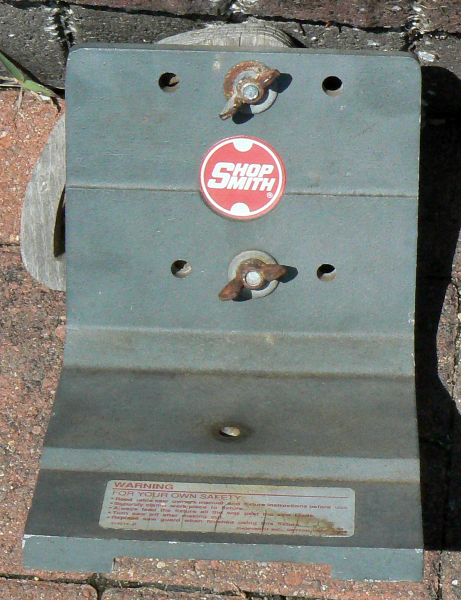

Tenon Master Refurb
[ATTACH]13980[/ATTACH]
[ATTACH]13981[/ATTACH]
[ATTACH]13982[/ATTACH]
[ATTACH]13983[/ATTACH]No, you are not the only ones participating. I am just not sure of the questions. They seem more like statements to me.
With one exception. The base plate is 3 1/4" x 5 3/4".

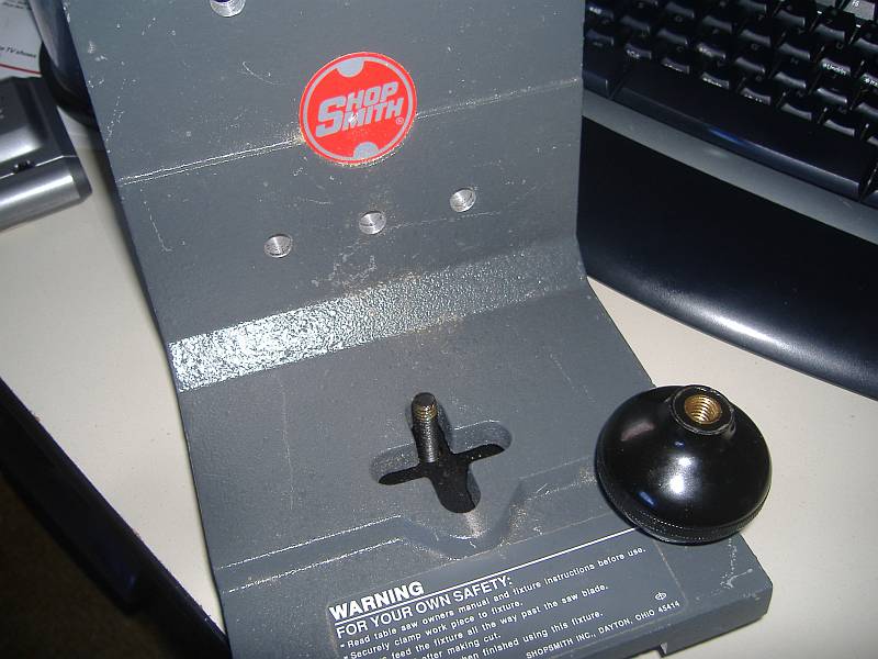

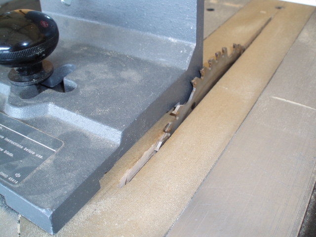

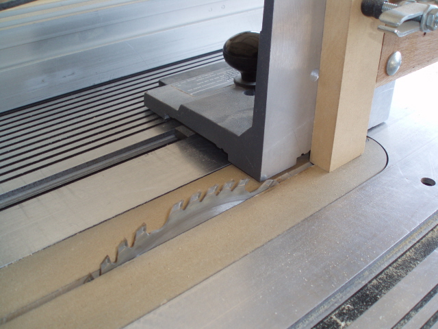

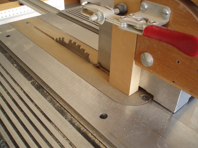

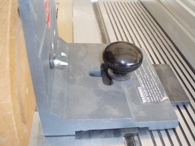

Hi,
Large "+"
[ATTACH]13977[/ATTACH]

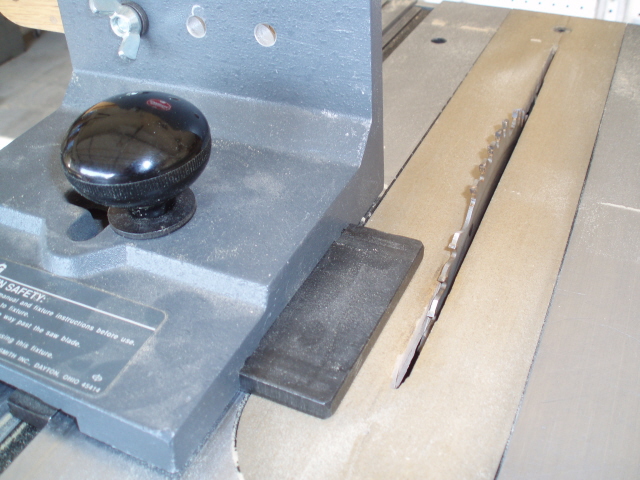

The plate can be mounted two ways depending on what operations you want to do.
[ATTACH]13978[/ATTACH]
[ATTACH]13979[/ATTACH]
Large "+"

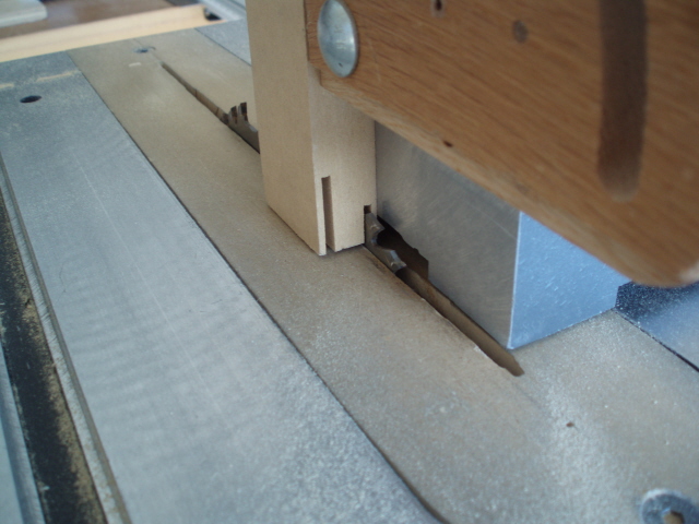

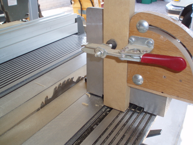

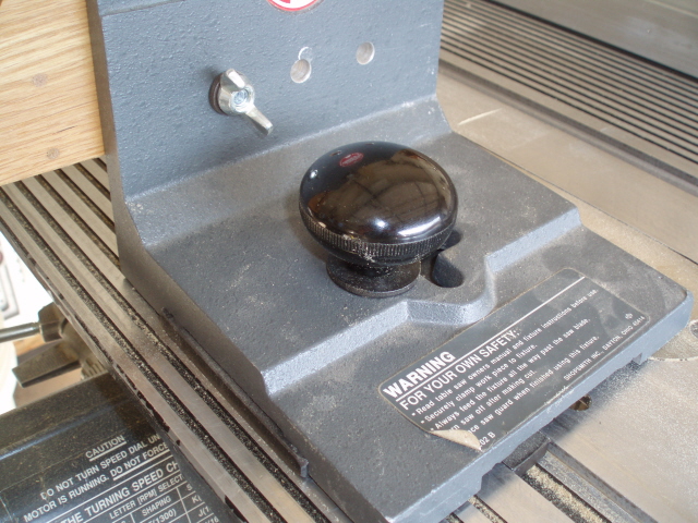

Tenon Master (more photos)
If you are left with questions, ask.

Thank You Dusty!
Yes my questions were in the form of (guesses) statements looking for 'correction' if inaccurate.
NEVER be reluctant to correct anything I say!!!!!!
So apparently there are at least two versions. The "+" makes adjustment method(s) obvious and explains the reason for the 'slots' in both axis.
Sadly the one I have acquired has only a single 5/16" hole where the knob attaches. If the original plate had a similar "+" milled into it and it was steel, considering the condition of the rest of the jig, it would have appeared hopeless and was probably discarded.
Seems I will need to be more 'creative' than at first envisioned.

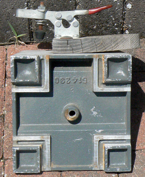

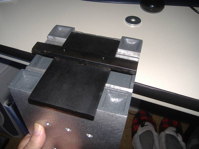

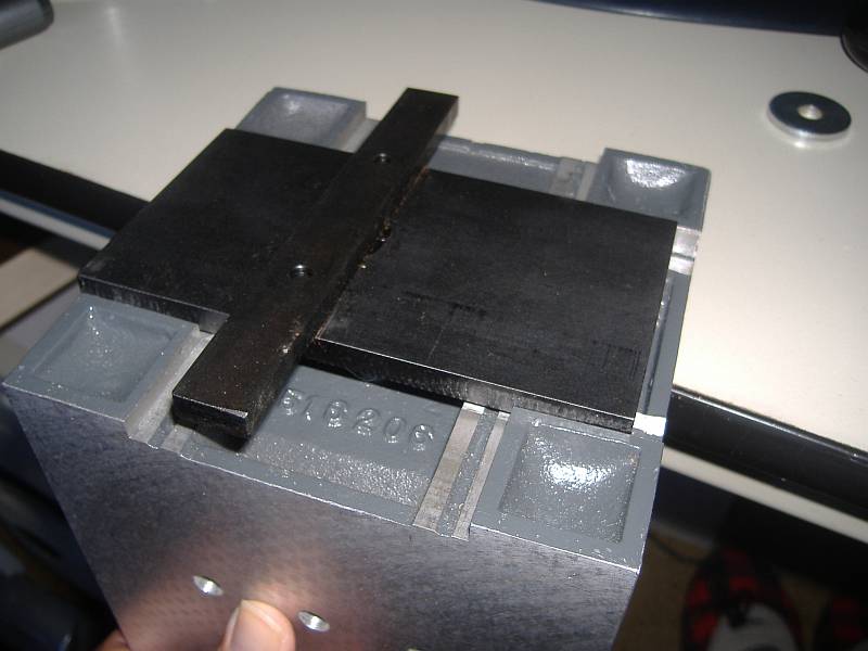

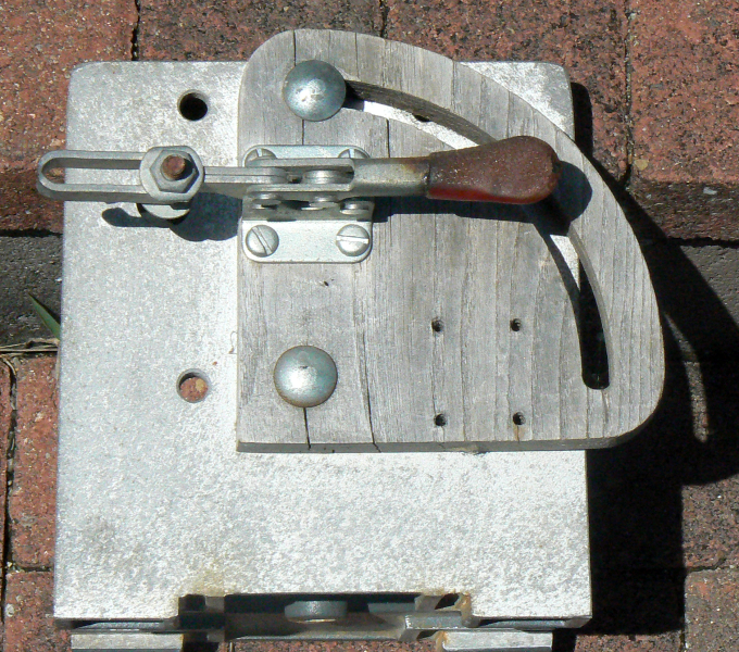

B4 pix of 'older' Tenon Master Jig
This will explain much of the reason for my ?? regarding adjusting position of plate.
[ATTACH]13988[/ATTACH] [ATTACH]13990[/ATTACH]
[ATTACH]13989[/ATTACH]

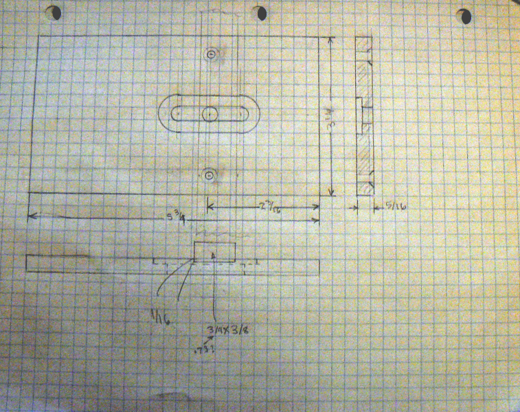

'MAYBE' what???dusty wrote:Aaah, I see.
MAYBE
JPG, for the model tenon jig you have, the steel base plate has one recessed slot centered in it for making the adjustments. The plate is held and locked in place using a carriage bolt, with a knob similar to the one used on the newer model. The slot is a bit wider than the square part of a carriage bolt (so the bolt doesn't rotate when tightening the knob) and the recess prevents the head of the bolt from protruding below the steel plate.
Art in Western Pennsylvania
pennview wrote:JPG, for the model tenon jig you have, the steel base plate has one recessed slot centered in it for making the adjustments. The plate is held and locked in place using a carriage bolt, with a knob similar to the one used on the newer model. The slot is a bit wider than the square part of a carriage bolt (so the bolt doesn't rotate when tightening the knob) and the recess prevents the head of the bolt from protruding below the steel plate.
Thank you. You just described what I have drawn up except I included a 1/16" deep slot for the miter bar so I could use a 3/8 x 3/4(trimmed to ss size) bar stock.
[ATTACH]13991[/ATTACH]
[The miter bar is mislocated in the drawing]
I will make a wood one first. May also be the 'last' if accurate/durable enough.
