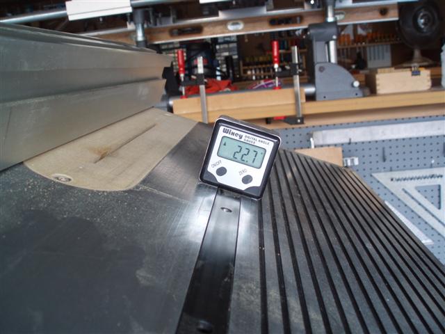

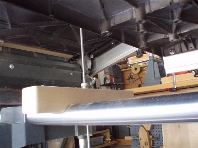

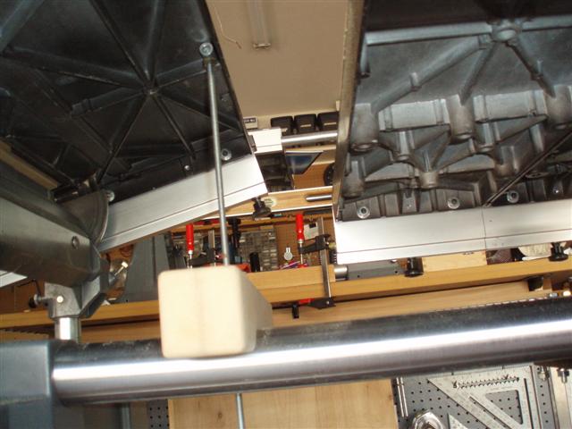

algale wrote:This is good advice. I am curious how those who have had to make bevel cuts using the tilting tables (especially the 510/520) have supported the tables. It occurs to me that the detachable/extendable legs might be used on the table tubes on the hight end of the tilted table (although with a really big set up involving multiple floating tables, the end might be too high for the extension legs?).
With unusually large projects, you would be better off taking the time to clear off your table saw and doing the work there. But on reasonably sized projects the Mark V tilting table works fine but can be improved with a bit off extra work.
I have made up two blocks that bridge the bench tubes and have a hole to accept a threaded rod (see attached image for clarification). I use the threaded rod to lend stability to the table.
I also use it as a micro-adjuster, along with a Wixey Angle Gauge, when tilting the table to a critical setting.
[ATTACH]14353[/ATTACH]
[ATTACH]14354[/ATTACH]
Just noticed the two pictures might be confusing; table is being tilted left in one and right in the other but I think you get the idea.

algale
Posts: 4828
Post by algale »
[quote="dusty"]With unusually large projects, you would be better off taking the time to clear off your table saw and doing the work there. But on reasonably sized projects the Mark V tilting table works fine but can be improved with a bit off extra work.
Just noticed the two pictures might be confusing]
Dusty, I like your jig a lot! I may have to make me on to use with my Beal tilt box. It seems like it would both add stability and make small and precise angle adjustments somewhat less of a hit or miss (or at least tap back and forth) exercise.

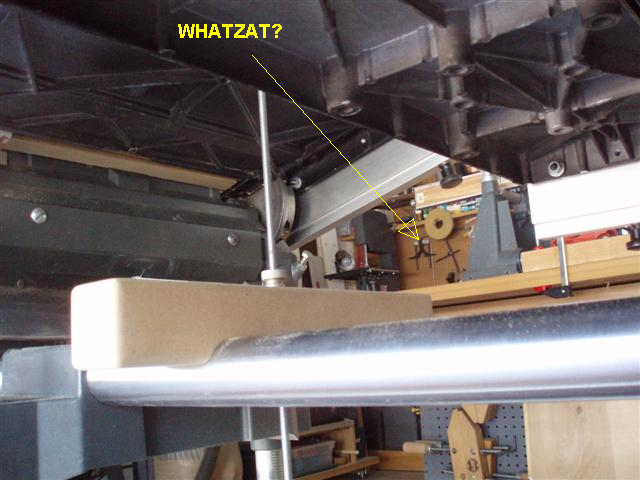

Posts: 35457
What Is It??????
Dusty:
[ATTACH]14356[/ATTACH]
Just curious!;)
WHATZAT DUSTY.jpg (176.28 KiB) Viewed 4568 times
damagi
Posts: 927
Joined: Wed Jan 06, 2010 6:06 pm
Location: near Seattle, WA
Post by damagi »
[quote="JPG40504"]Dusty:
Just curious!]
Looks like a router edge guide to me
damagi AT gmail DOT com
Posts: 21481
Just curious!]
That is a router edge guide for a router that I no longer have. I keep it because it looks like it might come in handy someday; one just never knows.
