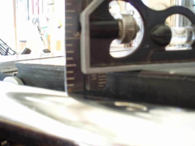

I do not have a jig but I use a piece of wood of the proper thickness to position the rails. The object is to get the rails all the same height (with respect to the table surface). Since the position of the rails is really "not adjustable" many folks I believe do not address this issue. I tinker with loosening and retightening the rail screws to get them set properly.
I do this with the tables resting upside down on my work bench and that long "feeler gauge" piece of wood between the bench top and the rails. If necessary, I run that feeler gauge through the planer to get it the right thickness.
I guess I should do that, label the resulting "feeler gauge" and call it a jig. I have not felt this to be a critical issue so have not done this. Once setup properly this hardly ever needs to be redone.
billmayo wrote:Has anyone made a jig to help align the 510 floating and extension table and tubes to the 510 main table and tubes? I see posts relating to problems getting and keeping the 510 tables aligned. I understand the use of different tube sizes & mountings (different years made) may be one area to look at. I do not have a 510 setup in my shop so have not seen this problem.
It looks like 3/8" is the required dimension.
[ATTACH]14646[/ATTACH]
