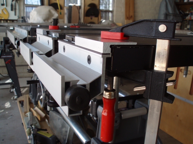

wa2crk wrote:There is an alignment device that is a piece of flat aluminum stock with a lip. It is used by laying the device on a flat surface on a table and placing the work table on it upside down. It sets the spacing from the table surface to the top of the extruded rails. It was included with all 520 upgrades.
Bill V
Yes there is. The picture shows that alignment device (2) being used in a different manner than you describe but it works either way. The objective is really to get the front rails all set at exactly the same height (with respect to the Main Table top) over their entire length.
[ATTACH]14645[/ATTACH]
Shown here are the Extension Table and a Floating Table being aligned together. Getting these and the Main Table all the same is essential to the rip fence working properly (accurately) no matter where it is positioned. The front edge of all the front rails being employed must be coplanar for both accuracy and smoothness of operation to be possible.
