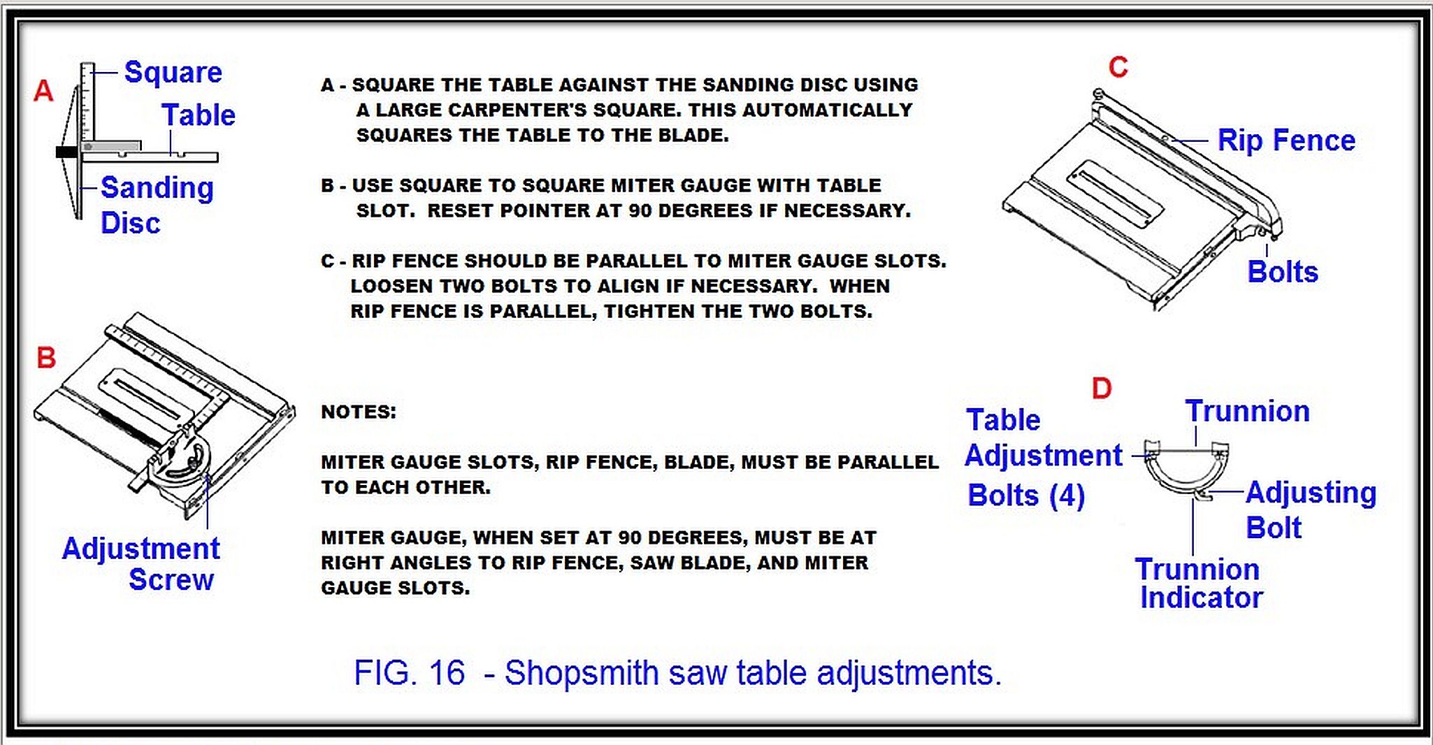

And*
alignment summary.jpg (290.84 KiB) Viewed 327944 times
