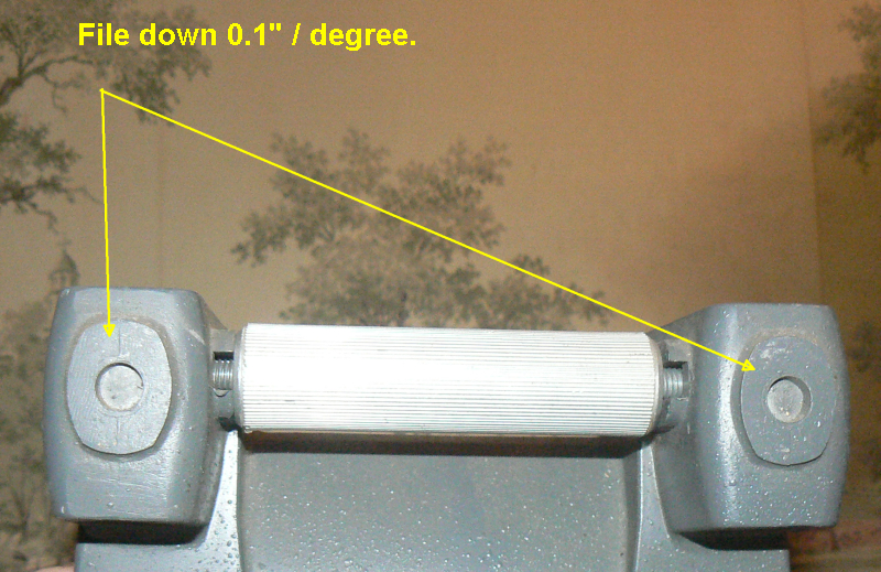

If you MUST achieve 90° 'tilt', do so by filing down the projections on the end of the hinge casting. They serve as a stop for the vertical position. When raised, those projections rest on the horizontal surface of the fixed portion of the hinged end casting.
I will add i pix if I can find one.
[ATTACH]15033[/ATTACH]
I had to create one!!
vert adj by filing.jpg (605.96 KiB) Viewed 1714 times

JPG40504 wrote:If you MUST achieve 90° 'tilt', do so by filing down the projections on the end of the hinge casting. They serve as a stop for the vertical position. When raised, those projections rest on the horizontal surface of the fixed portion of the hinged end casting.
Another one of those things they had considered when they designed the old Mark VII... It has adjustable stops on both ends for alignment when vertical. They may have been thinking that the pivot points might eventually wear enough to need some adjustment.

dusty wrote:"I need to add around 1.5" of packing under the headrest end legs to get it near vertical and then adjust the main table to get the table headstock at right-angles."
This is a quote from the opening post. If he had to lift the legs up 1.5" to achieve vertical - I don't think you have enough latitude to correct the problem by doing this.
Actually, I doubt that we know what the real problem is yet.
Again I say, pictures would be a great help in understanding this.
In the meantime: How many degrees of additional rotation would it take to produce vertical way tubes.
As I understood it, that 1.5" increase was to the left end which was almost 5' from the pivot point at the opposite end. The .1" is at a 5" radius from the pivot pin.
1.5/60 = 0.025
.1/5 = 0.02
Angles are close!!!!
Really not much to unnerstand!:D The ss does not rotate exactly 90° from 'horizontal' to 'vertical' (nor does it matter!!!!) As far as I am concerned, the only angle requirement is so that the balance point/CG is passed prior to it being 'stopped'/secured. That allows the balance stress to be towards remaining 'vertical'. The lock is to prevent it falling if the CG somehow gets shifted back towards the left end by workpiece loads etc.
Are we going to be concerned if the way tubes are not exactly horizontal when it is lowered?:rolleyes: Of course not, nor should we be concerned that the tubes are not vertical when raised.
Cut him some slack, he is 'new' and rightfully proud of his new acquisition and wants it to be perfect even though all things do not need to be so nor are they! The important things are close enough!!! We need to help him 'overcome' his new found tool enthusiasm by listening and hopefully get him to accept the things that really do not matter!;)

Mine does not rotate to 90° either. Mine only rotates to 89.1°.
I think that is different than I have previously reported but then that might have been on a different machine. I am not at all alarmed by that. This is not a critical setup.
I did some additional experimenting with this and here are the results:
With a .040" thick shim inserted, it rotates to 88.7°.
With a .235" thick shim inserted, it rotates to 85.8°.
Vertical Drilling - not quite vertical.
Emperical data indicates that this issue would not be that difficult to resolve.
Mine could be made to rise to a full 90° by simply filing off .072" as JPG had suggested.
