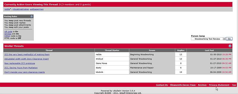

Hi,
I don't know if most or any of you look father down on the thread page, if you don't you might want to.
This is what I'm talking about:
[ATTACH]15212[/ATTACH]
It gives you more associated reading if you care to. It is also nice to search on zci where you will find a LOT more posts. We really have a library of information here at the forums if you care to look around a bit.
ScreenHunter_03 Dec. 12 13.38.jpg (33.83 KiB) Viewed 1643 times
reible wrote:Hi,
I'll be darned. Has that feature always been there?:o:o:o
