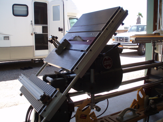

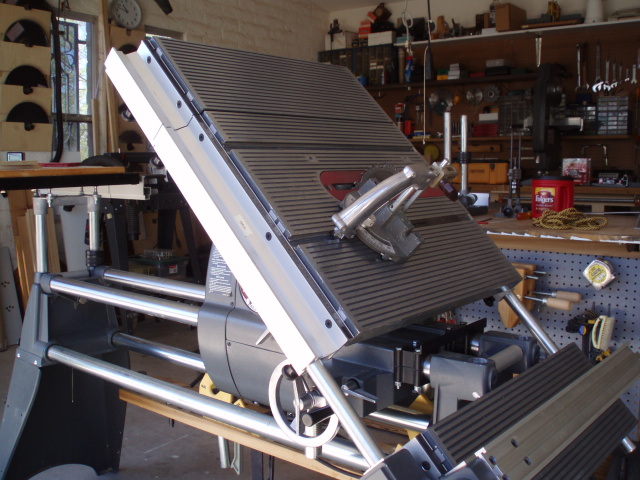

OH! A 42" long board that is 8" wide hanging on the tilted table is a monumental task without some clamping. In fact, cutting long boards accurately on a flat table can be a problem.
Maybe I could have done it in my early years before I began losing grip on my grip. Not now.
If I am looking for a real accurate cut I clamp even small pieces.
Have you tried using a sliding table with the table tilted?
[ATTACH]15541[/ATTACH]
[ATTACH]15542[/ATTACH]
:eek::eek: DON"T DO WHAT I HAVE SHOWN HERE!! It is equally taboo to use the miter gauge in conjunction with the rip fence while using the table tilted.
The cutoff, on the high side of the blade, is something that needs to be dealt with also. That piece will CERTAINLY slide down into the blade if not managed.
I managed to do just that, yesterday, while playing with this issue. The salvation was in the fact that the piece was very small and simply got kicked out of the way. What I did was NOT SMART.

I'm probably missing something but with respect to performing a bevel cross cut on a long work piece, why let the cut off be on the high side of the blade at all? Wouldn't it be advantageous to mount the extension table on the "up hill" side of the blade (minus the rip fence of course) and move the miter gauge (or cross cut sled) into the left hand (up hill) miter gauge slot? Then you can let the cut off drop harmlessly away from the blade and on to the floor. When performing a bevel cross cut using the miter gauge there is always going to be the issue of managing the weight of the work piece while making the cut; but the problem of managing the weight of the work piece is going to be the same whether work piece and the miter gauge are positioned above the blade or below the blade. There might even be a slight advantage to having the work piece above the blade if you install the blade guard with its integral splitter because once the edge of the work piece is beyond the rear of the blade the splitter will tend to prevent the work piece from sliding down hill into the blade. Regardless, by putting the work piece and miter gauge on the up hill side of the blade in a bevel cross cut you can let gravity be your friend on the cut off. You can also turn the work piece over if you need to keep the angle relative to a particular face of the work piece.
In contrast, on bevel rip cuts I see a huge advantage of keeping the work piece and rip fence on the down hill side of the blade because the rip fence supports the weight of the work piece and helps keep alignment of the work piece to the fence. In that case you do have to be very concerned about the waste piece being above the blade. Again, the blade guard with its integral splitter is some help in that scenario since it tends to keep the waste piece from dropping on to the blade.
