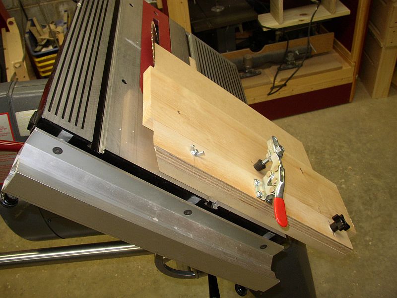

In the table project from the Christmas post, I mentioned that the aprons were beveled 45 degrees in the corners. The aprons were about 8" wide and I wanted to have good tight fittting joints. I tried cutting them with the miter gauge with the hold down grip, but was never satisfied with the fit. It seems that I couldn't hold everything perfectly while making the cut.
[ATTACH]15526[/ATTACH]

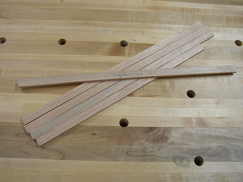

I almost always have some hardwood runners to fit the Shopsmith miter slot (I make them a dozen or so at a time) so I decided a bevel sled was the answer.
[ATTACH]15527[/ATTACH]

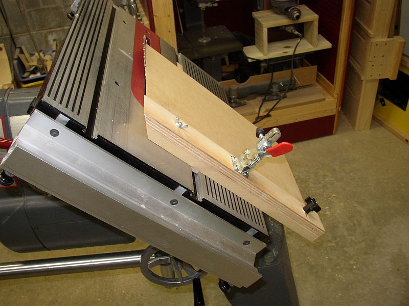

This is the completed sled with a plywood fence and toggle clamp hold down. The base is simply some MDF. I made the sled so it would be trimmed to zero clearance on the first cut. You might also notice that the fence is slightly adjustable and I'll go into why I did this in a minute.
[ATTACH]15528[/ATTACH]
This picture shows the table at 45 degrees, the blade set and the sled trimmed.

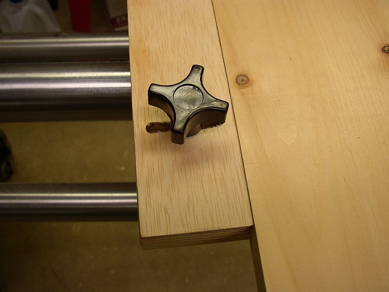

I mentioned that the fence is adjustable and I made it that way because even though I get perfectly square cuts when the table is at 90 degrees, they are always slightly off at 45 degrees. I am quite sure this must be due to the table being either slightly higher or lower at the back as compared to the front. This would not affect a 90 degree cut but it does affect a bevel cut. Rather than take the time to get the table perfect, I chose to make the fence adjustable so I could compensate for this. It worked perfectly.
Continued in next post.

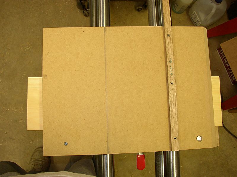

[attach]15530[/attach]
This shows the underside of the sled with the runner attached. I do use a little trick to attach runners. I first make sure my base is square and mark the position of the runner. I then locate the runner in the proper position and clamp a square to keep is straight. While holding the runner against the square I wick a little thin CA glue under the runner. Five seconds later the runner is temporarily fixed in position allowing me to drill and countersink for the screws. This trick works every time and the runner never moves when I secure it.

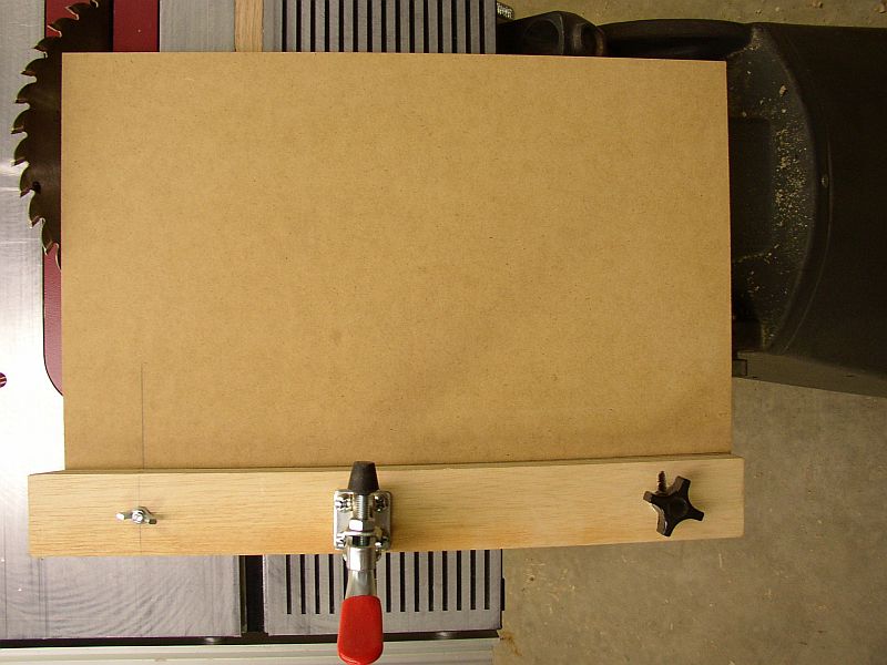

[attach]15531[/attach]
This shows everything all set up and ready to cut.
